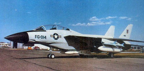

I'm surprised there weren't more ideas looked at doing that with the Tomcat. Just this one AFAIK.

I don't think the bottom of the front fuselage is actually flattened, most likely an optical illusion caused by motion blur.
I'm guessing folding the forward landing gear into the CFT would be a bit of a pain in the ass.
Probably carrier bring back issues. The F-16's CFT pair is 900 pounds and they don't have to carry anything. The F-14's would have to be structurally reinforced to carry Phoenixes and Sparrows in addition to being much larger. A shame because a CFT probably would have helped out a lot in the FAD missions. If the F-14 had received more land based export orders it might have popped up again as well.
The F-14 doesn't have a lot of room between it engines ducts, so i'm really not surprised
The only decent room is at the aft of the aircraft, which is not an ideal place to fit such device
