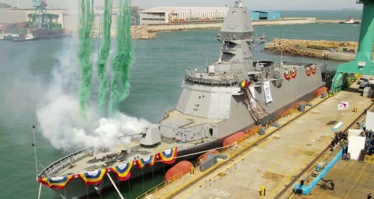

What is possible, the South Korean 4,300t Chungnam class frigate which is 200t lighter than the 4,500t OPC
From what limited info seen - FFX Batch III Chungnam class frigates 129m length, 14.8m beam, 4,300t full load displacement, CODLOG propulsion system, DRS hybrid propulsion for 17 knots and its powerful RR MT30 GT for max cruise speed of 30 knots. Fitted with an integrated mast dubbed "semi-Aegis" with four panel AESA array, IRST and EOTS. Armed with 16-cell KVLS (Korean Vertical Launching System), Mk.45 5-inch main gun, CIWS-II 30mm gatling gun with its dedicated X-band AESA FCR, 16-cell KVLS (K-SAAM) system (Korean equivalent of RAM) eight angled launchers for anti-ship sea skimming C-Star missile and the land attack Tactical Surface Launch Missile, Sea Dragon, as well as 324mm torpedo launchers for LWT Blue Shark torpedo, SQR-250K TASS, low frequency passive sonar system.
Nov. 2023 Hanwha awarded a 792 billion won/$612 million contract, $306 million each, to build the final two before progressing to FFX Batch IV, any possible chance that Navy and US yard could combine to build similar frigate for $500 million?

The Koreans also don't really need blue water ships capable of fighting in the middle of the Atlantic or Pacific in bad weather.
And there's no way to tell if the Damage Control and such of those ships is up to USN standards.
I'm sure the Korean 4,300t frigates are designed to a standard to take bad weather, though as you say no way to tell if the DC is to USN standards, but would have thought that does not make a $500 million US yard build frigate an impossible pipe dream.
Yes, there's a reason one of HII's proposals for the Frigate program was based on an enlarged Legend-Class cutter.
Even with that, HI filed for an exemption from some of the requirements. If I remember correctly, they advocated for fewer installed VLS.
Obviously, the Navy didn't go for it.
That FFG(X) has about a third less fuel range than the USN FFG-62. Which is probably also reflected in other stores and spares stowage.
The ROKN also has conscription so it may not have to spend as much effort on habitability. But it also probably relies more on repair by replacement, which cuts crew needs.
Unlikely.
Seakeeping and habitability alone are going to be rough.
Seakeeping: That ship is not designed to be out in the North Atlantic in the winter. It's not even really designed to enter the Pacific proper, it's a coastal Frigate. It has limited range even given the efficient low speed engineroom.
Habitability: The Koreans still conscript, so their crew berthing isn't even as nice as the USN 3-high coffin racks. The 95% Korean is about 5'8", the 95% American is 6'2", so their decks are closer together. Passageways are narrower, too.
