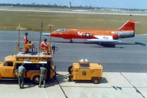

Does anybody know what this is? An afterburner for the afterburner? (Source)

Some sort of IR shield perhaps? Similar in concept to that on the Israeli A-4s.

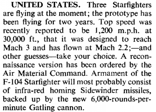

A new info for me,
the Lockheed F-104 intended to reach Mach 3 ?,Air Pictorial 9/1956.

Late, I know, but I would say that Circle-5's F-104B has an experimental ejector nozzle, possibly associated with the SST program. It has a buzz number which makes it a bit early for anyone to be thinking about IR suppression.

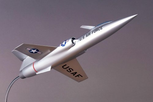

Lockheed CL-981 retractable canard wing design study (mfr LA 5012 via RJF)
PictionID:42253147
Title: Lockheed CL-981 retractable canard wing design study (mfr LA 5012 via RJF)
Catalog: 17_000009
Filename: 17_000009.tif
Image from the René Francillon Photo Archive at San Diego Air and Space Museum Archive.
Link: https://www.flickr.com/photos/sdasmarchives/16950031030/in/set-72157651530128190

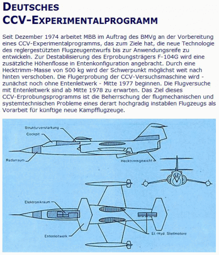

the Lockheed F-104 CCV.
http://www.rolfferch.de/F104G/html/projekte.html

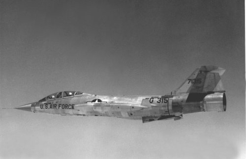

Here's another variant: QF-104A remote control drone flown at Eglin AFB, Florida.

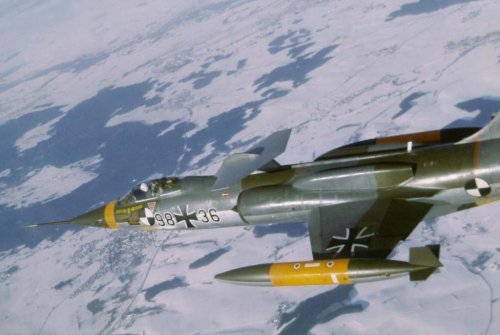

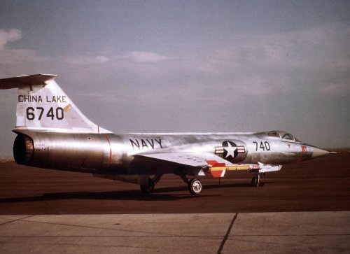

Here's a fun one. A Navy F-104 used for weapons tests at China Lake.

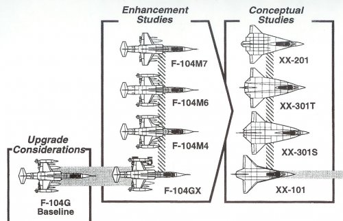

Here's one. Not sure which book it came from.

Well those are new. The Conceptual Studies almost look like the Vought SAMI concepts.
Interesting find!

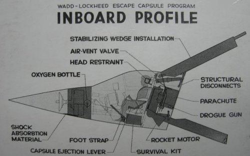

Due to the dangers associated with the Stanley B downward ejection seat developed for early model F-104's a capsule approach was considered.

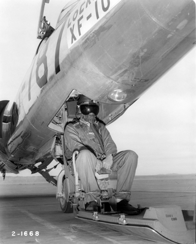

XF-104's downward ejection system.
Arjen
It's turtles all the way down
Nov 6, 2010
3,232
1,440
Posted earlier in the Napier Rocket Engines thread:
In 'Lockheed's Skunk Works', Jay Miller writes downward ejection was chosen because
- it promised lower escape g's
- better instrument panel position
- easier clearing the various sharp edges of the F-104's T-tail on ejection
- better tie-in of the lower escape hatch with the seat than was possible with ejectable canopies
Michel Van
ACCESS: Above Top Secret
Aug 13, 2007
5,877
3,506
what for excellent finding, Dynoman
Since the F-104 was original design as high-speed, high-altitude fighter/interceptor.
The downward firing Ejection seat was consider ideal, by passing the "T-tail" empennage.
but deaths of 21 USAF pilots, do low-level emergencies with downward firing Ejection seat, let to installment of C-2 upward-firing seat.

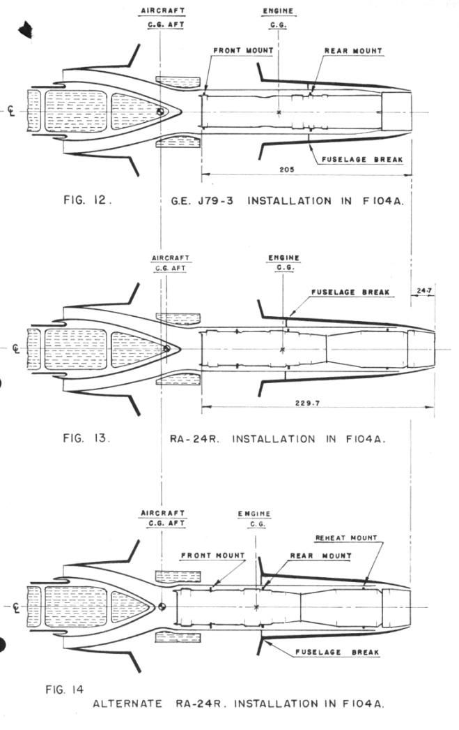

One that I wasn't previously aware of: apparently back before they settled on the Mirage III there was Australian interest in a RR Avon powered version of the F-104:

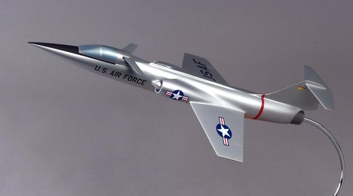

Lockheed CL-981 manufacturer's display model.
In addition to the retractable canard, the wing is larger than a standard F-104 wing (250 sq.ft. vs. 230 sq.ft.) This larger wing is different from the NF-104 wing, which had simple tip extensions to position the RCS roll nozzles further outboard (to increase their effectiveness). Instead, the CL-981 extensions were at the wing root, with a dihedral reduction from 10 to 7 degrees. The CL-981 would have been equipped with an uprated J79/J1Q engine with auxiliary inlet doors.

German F-104 CCV
Dynoman
Jul 29, 2009
1,172
678
F-104 CCV Article
  • F-104CCV_Classic Aircraft, Zeitler Andreas_2012.pdf
