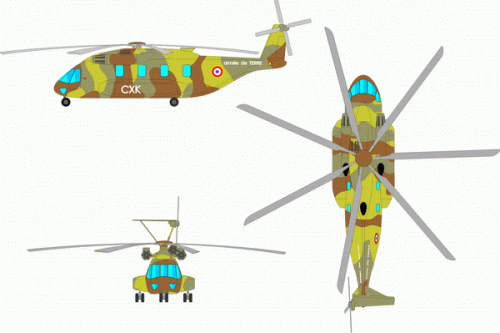

overscan said:Current project for a Heavy Transport Helicopter
Aviation International News July 17 (Farnborough)

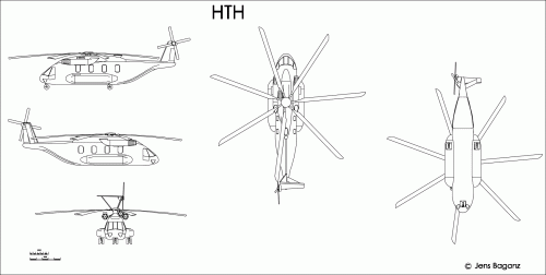

overscan said:Unfortunately its a tiny diagram (a few cm across) and thats the best I can do with it.
pometablava said:It is the Eurocopter HTH

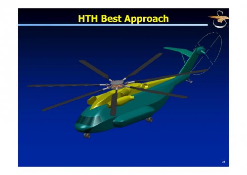

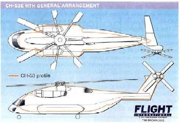

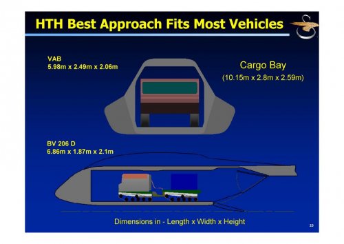

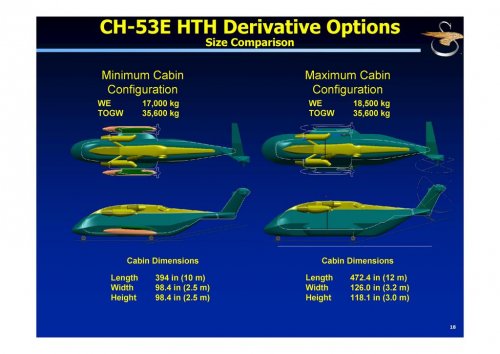

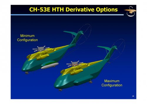

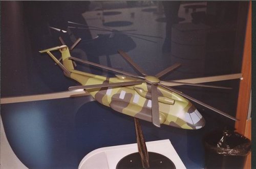

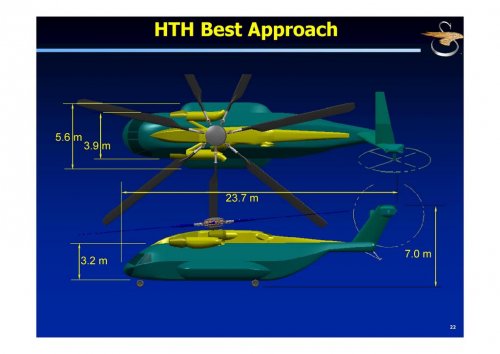

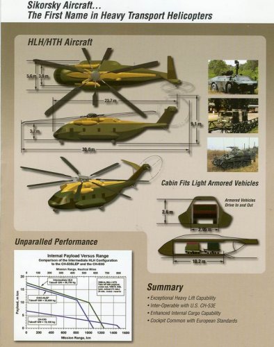

CammNut said:Just uncovered these from a 2002 presentation by Sikorsky - a derivative of the CH-53E to meet the European HTH requirement. Talks continue, so there is probably an updated concept based on the CH-53K.
sferrin said:CH-53Ks for everybody!![]()

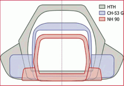

Although Germany's requirement is to replace its CH-53Gs, the new CH-53K isn't big enough to meet the FTH requirement, which calls for a cabin large enough to transport light armored vehicles. But the CH-53K's new dynamic system might be big enough for the job if mated to a new, larger airframe.

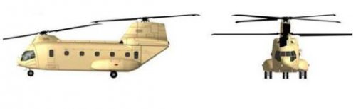

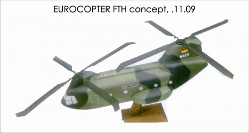

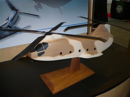

Source (PDF): http://www.eda.europa.eu/WebUtils/downloadfile.aspx?FileID=532Triton said:It seems that the idea of a new European program to develop a new helicopter for the Future Transport Helicopter (FTH) program is dead.
According to Bill Sweetman, Boeing is interested in the program and has proposed a derivative of its CH-47 Chinook.

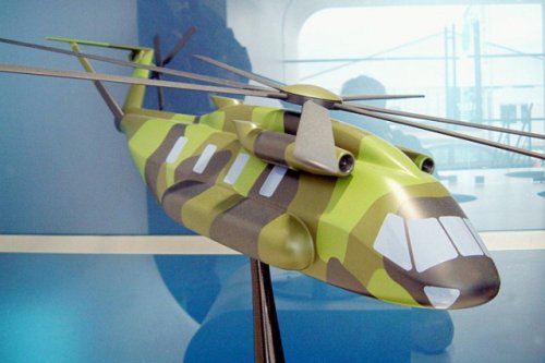

ILA 2004: Eurocopter unveils Heavy Transport Helicopter concept
ROBERT HEWSON Editor, Jane's Air-Launched Weapons
Berlin
The German Army's CH-53G replacement requirement is driving Eurocopter's new Heavy Transport Helicopter (HTH) concept that was shown for the first time at the International Aerospace Exhibition in Berlin.
However, Eurocopter admits that the European market for helicopters in this class will not support an independent development programme and the company is looking to the US Marine Corps' CH-53X effort.
The three-engined HTH draws on NH90 experience, using Eurocopter's fly-by-wire control system and composite structure technology. With a payload of between 10 and 13 tons, carrying 70 troops, the HTH would have a maximum range of 1,200km without refuelling. Eurocopter has described the HTH as possibly the "Airbus A380 of helicopters" and hopes that it might become the basis for a new European-US co-operative development programme. German officials have already said that they do not favour a CH-53 upgrade and would prefer to acquire a new aircraft.

Cabin length : at least 10 m
Cabin width: at least 3 m
Cabin height: at least 1,6 m

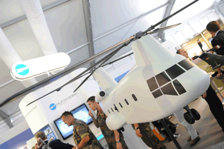

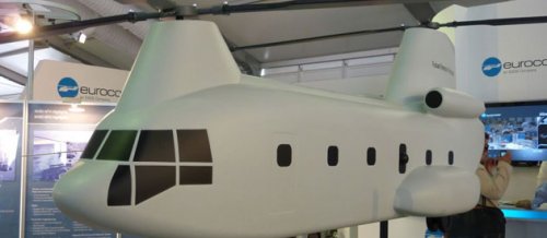

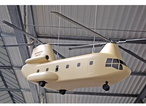

Source: Aviation Week - ILA Berlin Air Show 2012 - German Heavy Lift: Buy Big, or Think Smaller?Amy Butler said:Details are expected to emerge this week of a joint venture between EADS and Boeing to capture work for Germany’s next-generation heavy-lift helicopter program.
EADS is displaying its joint concept with Boeing, including diagrams of a proposed tandem-rotor design and a full-scale cross section of the proposed cabin for the aircraft. It looks much like an enlarged CH-47 Chinook, built by Boeing. It is likely that Boeing’s contribution to this design would be providing the tandem-rotor technology and dynamics of the aircraft. [...]
