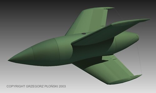

Does anyone have or know of any specifications or drawings of the Enzian E-5 proposed supersonic version of this missile?
From nearly 20 years ago: https://web.archive.org/web/2004081...ystok.pl/~hess/r_ppk_messerschmitt_enzian.htm
Length 4600 mm,
Wingspan 2450 mm,
Fuselage diameter 876 mm,
Launch weight 1900 [2000?] kg,
Fuel weight 600 kg,
HE weight 225 kg,
Max thrust 2500 kG,
Max. speed 1800-2340 km/h,
Ceiling 15 000 m,
Range 30 000 m.
Generally it was to be a tailless design with four swept wings spaced evenly around the fuselage in the X fashion.
