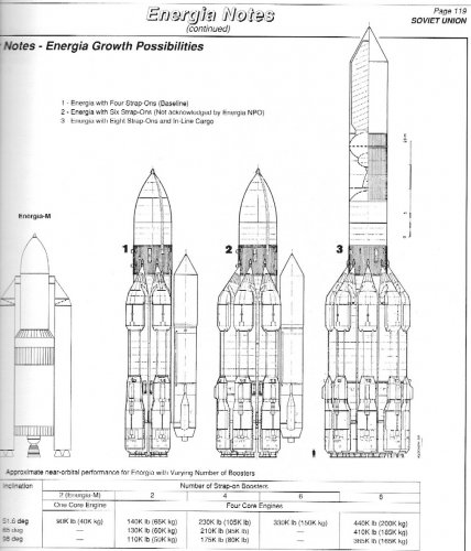

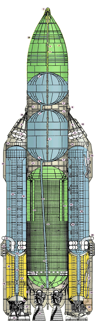

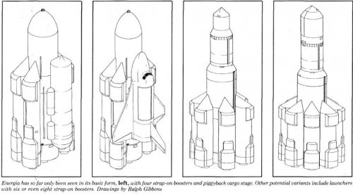

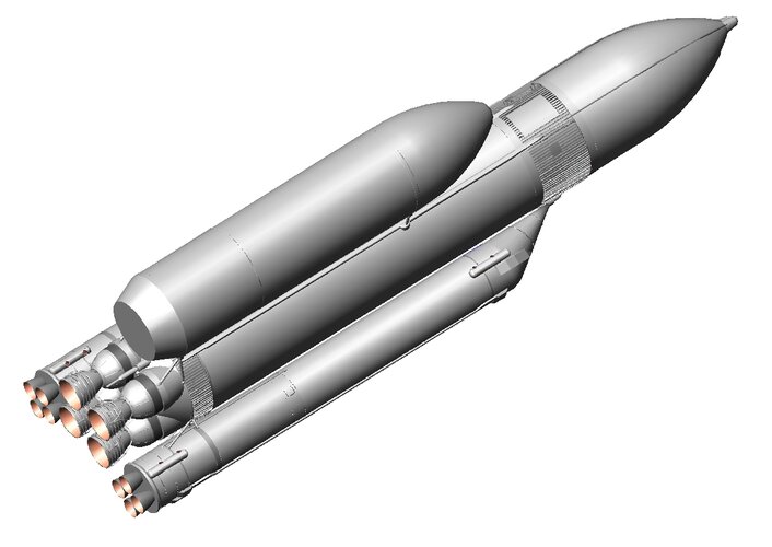

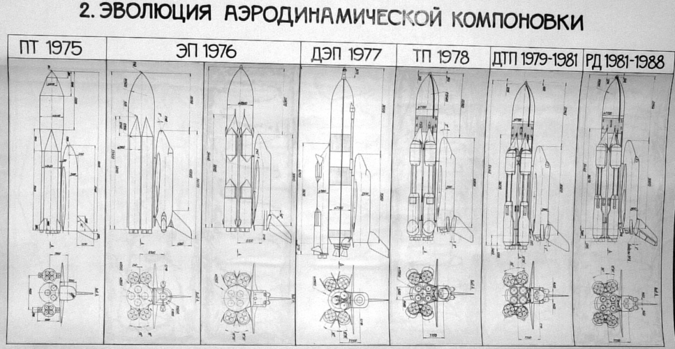

Energiya heavy-lift launch vehicle variants

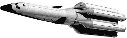

Projected growth variants of Energia, including in-line variant referred to in some sources as "Vulkain" or "Heracles." From an older edition of "International Reference Guide to Space Launch Systems," Steven Isakowitz.

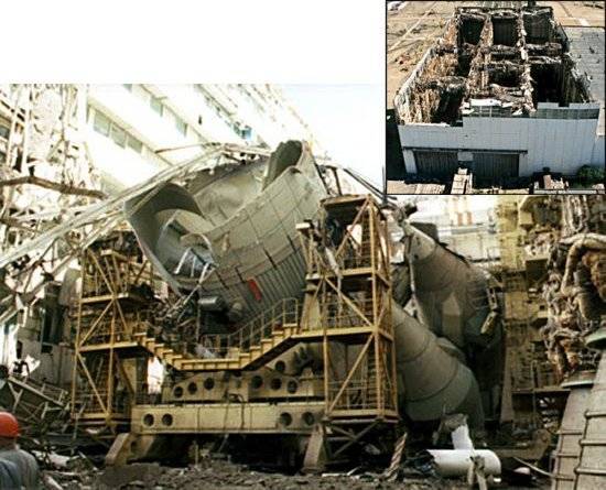

total 100 % Dead
from
http://www.aerospaceweb.org/question/spacecraft/q0153.shtml
i had tears in eyes seeing this ...

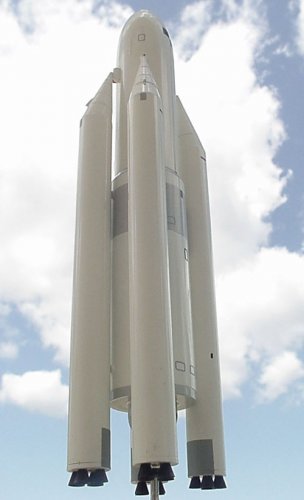

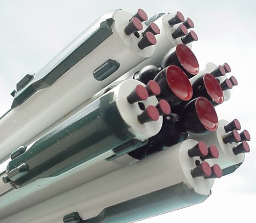

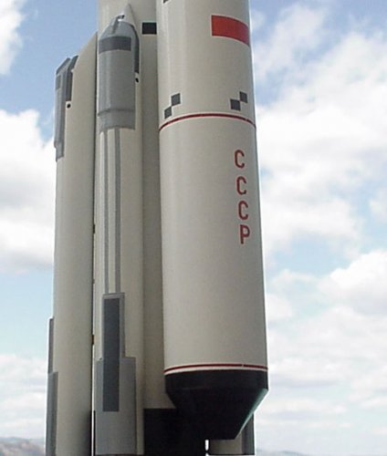

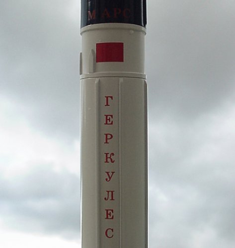

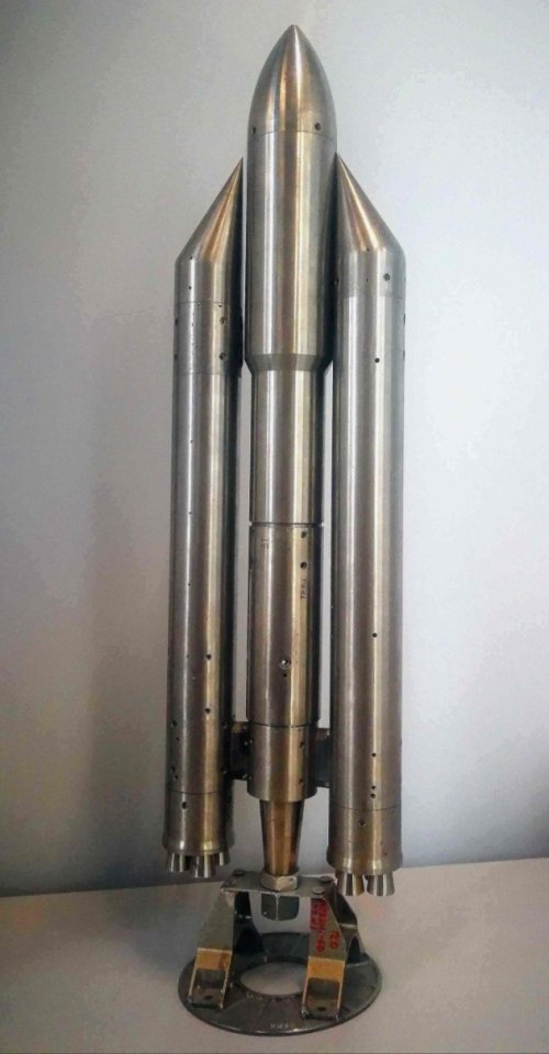

Model of Energiya Herkules from the USSR-Russian Aviation and Space Collectibles web site.
NOTE: Although seller claims that model is authentic and accurate, the reader should be aware that the authenticity and accuracy of this model is in question. It may have been manufactured by another party without license.
21.5 ` height metal custom made exclusive of Energia Corporation project rocket Herkules, designed on base of Energia booster and intended for flights to Mars.Contact for details.
Item 70/117
http://www.ussr-airspace.com/index.php?main_page=product_info&cPath=24_53&products_id=1312
Seller's claim of authenticity:
http://www.ussr-airspace.com/index.php?main_page=product_info&cPath=28_39_48&products_id=845
Are Herkules and Vulkain two names that refer to the same variant in the Energiya-family of launch vehicles?

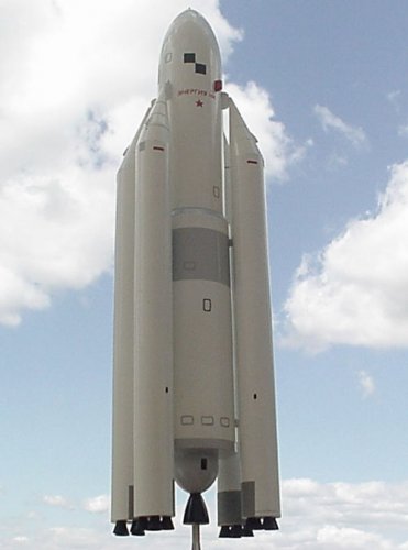

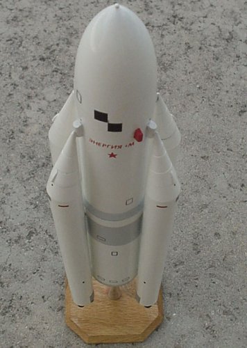

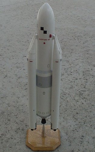

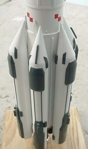

Model of Energiya-M from the USSR-Russian Space Collectibles web site.
15 Inches tall made from metal Energia Coirporation model of Energia-M launch rocket on wooden stand. Only one model available. *Availability and price check by e-mail or call.* + shipping.Details on this rocket carrier are below. Energia-M was competitor in a new Russian Heavy Launch Vehicle competion in 1993. The aim was to replace the Proton rocket. Energia-M lost the competion and as a result the Angara Launch System was choosen for development by the Russian Space Agency. Energia-M development has been abandonned. Perhaps in the future it could be revived. Energia-M was derived from the Energia Launch System used by the Buran. In comparison to Energia, Energia-M utilized 2 strap-ons instead of 4 and the core booster used 1 RD-0120 instead of Energia`s 4 engines.
http://www.ussr-airspace.com/index.php?main_page=product_info&cPath=24_53&products_id=1497

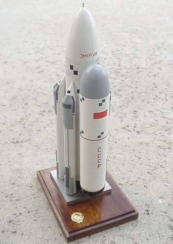

Model of Energiya launch vehicle with in-line cargo from the USSR-Russian Space Collectibles web site.
Energia rocket with Mock-up of Spaceship
Same as listed above Energia corporation presentation model on wooden base with attached metal Soviet Crest emblem.About 11 inches tall. Entire model is made from metal. Heavy. Available only one.
http://www.ussr-airspace.com/index.php?main_page=product_info&cPath=24_53&products_id=1496
..."Gherkules" was one of those "code names" for the N-1 that popped up in the early to mid-80's. IIRC, this was one that Art Bozlee was pushing around with his Soviet space secrets talks, and I *think* it got totally debunked by Jim Oberg right around the time George Herbert was splitting sci.space.* into several decent specialized groups while leaving .policy to fester and hopefully die on its own.
..."Vulkan", on the other hand, was another Energia variant:
http://www.astronautix.com/lvs/energia.htm

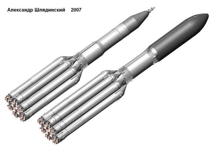

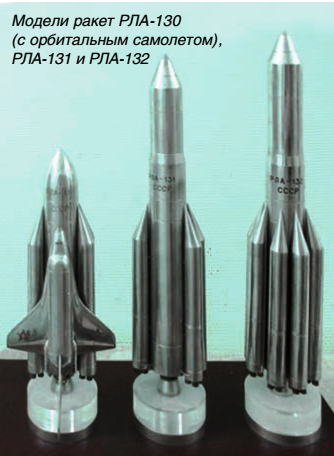

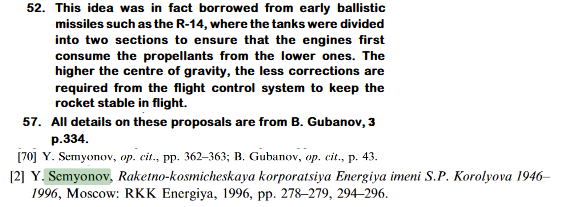

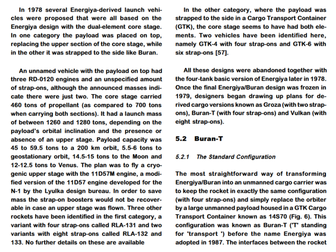

Does anyone else have more information on the late 1977-early 1978 " 4 tanks Core/ Upper Drop Tanks" Energia configuration. It's a really interesting (unique? I don't ever remember seeing any "upper drop tanks w/ crossfeed" anywhere else) concept and have been trying to find more information about it to no avail.

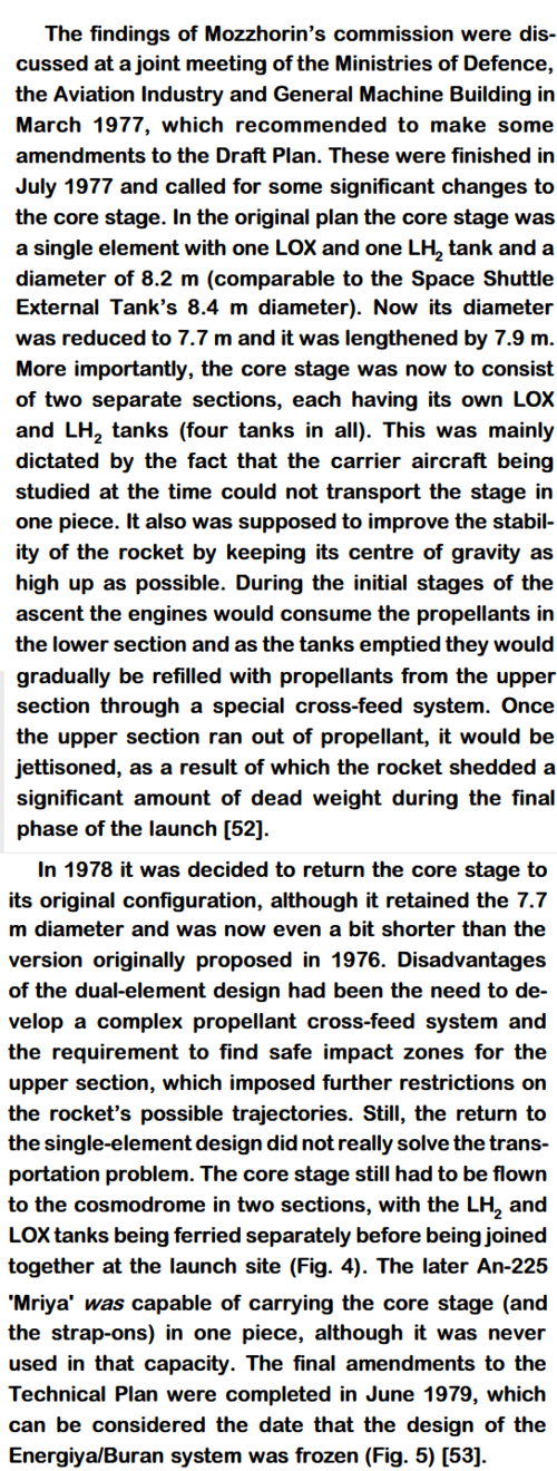

The main references are B. Hendrickx's Energia Buran book and The Origin and Evolution of Energiya rocket familly.
Gubanov's memoirs also add: ". The central unit was supposed to be transported by ZM-T aircraft in special containers in two half-blocks, of course, separately."
As you can see the core was split in two sections, the lower one simultaneously feeding the RD-0120 while being refilled with the upper one, the later which is then jettisoned once empty 1687820130455.png
This 2-parts core version also had derivatives. Some versions had the payload in-line (presumably, the lower part already had the structural strength to carry an upper stage without modifications, making a conversion to an In-line launcher easier than both Energia->Vulkan and STS->Direct/SLS), prefiguring in some way Energia-M; while others had a side payload like later cargo Energias.
Buganov's memoirs add that RLA-133 have "50% lengthened Zenits/Block A"
This part does say that the lower part of the core was supposed to have 460 tons of propellant, with the whole carrying 700 tons like the final Energia.

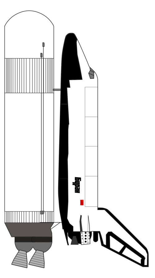

There's also this other unsourced image showing a 1977 version that actually fits the description , since it surprisingly has 2 intertanks sections. The position of the intertanks roughly fits with a 460 tons split-tanks lower section and a 240 tons common bulkhead upper section.
Common bulkhead on such a scale may seem hard but it's not like Buran's origins lacked ambitious proposals.
I cannot discern if this 1977 version is taller than the later proposals but it should be because (by a few m) of the additional intertank, since the propellant mass is the same (700 tons); it's clear that the upper section is a common bulkhead, since a third intertanks would lengthen the core even more.
I tentatively quickly extrapolated the arrangement of the tanks. I imagine LOX crossfeed was internal while LH2 crossfeed was through an external pipe since it's what fits the drawing.
Three RD-0120 configuration appears in both the drawing and the description of lighter version of this Energia. Note that RD-170 and RD-0120 thrust was not yet fixed at the time, with the later initially being set for 250 (vacuum) tons-force in a 3 engines configuration

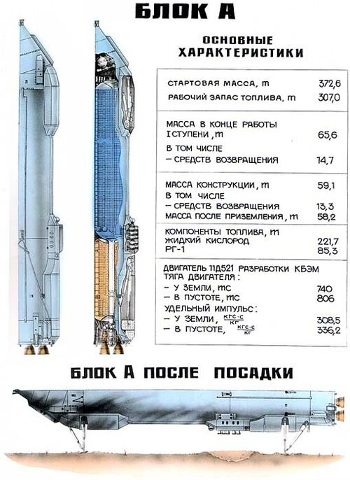

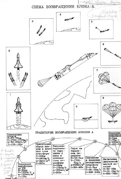

As for why the Zenits have fins, from Buganov again "Unit A, after the introduction of parachute landing aids into the design, acquired small aerodynamic planes in the nose and tail for stabilization of the unit in flight in the upper atmosphere."
I tried to draw what this 1977 Energia would look like after booster and core jetisson (which should happen around ~185 seconds in flight if the 3 RD-0120 aren't throttled down), It's definitely a weird sight.
Thank you for any additional informations
Here are the relevant sources from B. Hendrickx's works, I did not find additional informations in either original sources.

Now over at NSF--one Energiya Core seemed to have cover under the RD-0120....what was that about?
Those look like grid fins the Zenits are wearing.
Now, I thought the RLA series were going to be a tad larger than Zenits---but with no hydrogen core---at least...that was what Glushko wanted.
He hated hydrogen from what I read.
Wade has the RLA series all kerolox.
