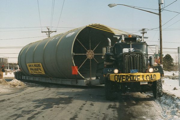

Such as: let's say you have an approximately 3.5-meter steel tube (which is about the diameter of the tube hyperloop is currently welding together to form another, larger test track). Your plan is to pump it down to about 0.1% of an atmosphere. How thick does the tube need to be to withstand external pressure against collapse? Now, how thick does it need to be once you factor in normal wear-and-tear dents? Assume everything from a vandal with a sledgehammer to a nut with a gun or a pipe bomb to a truck or plane crash.
Now, compare that thickness to the actual thickness of the tube that hyperloop is welding together. Here's a photo:
Note that X-brace inside? That's there to keep the tube from sagging under it's own weight... *before* it's pumped down. Once it's pumped down, that'll be another 14 or so pounds per square inch trying to crush it. Can it be made to work? Sure. But as Akin's Law #36 states:
Any run-of-the-mill engineer can design something which is elegant. A good engineer designs systems to be efficient. A great engineer designs them to be effective.
A good part of "effective" is that the hyperloop tube can be made not only adequately rugged, but reasonably inexpensive. These two tend to conflict. Especially when you factor in the need for not only periodic pressure doors to form airlocks, but also the innumerable car-sized hatches cut *sideways* into the tube.
Now, you can continue to rant about random internet nobodies... or you can man up and run the numbers and prove just how cheap all these problems will be to safely counter.
And with that it is extremely clear to me you havent even done the most basic bare bones research other than watching a clickbaity youtube video with 0 math. Because if you had, you would have seen this;
A tube wall thickness between 0.8and 0.9in.(20to 23mm) is necessary to provide sufficient strength for the load cases considered such as pressure differential, bending and buckling between pillars, loading due to the capsule weight and acceleration,as well as seismic considerations.
The tube wall thickness for the larger tube would be between 0.9and 1.0 in (23to 25mm).
http://www.spacex.com/sites/spacex/files/hyperloop_alpha-20130812.pdf
I will be waiting for your version of thickness needed, i am sure you will prove top nothing quality numbers.
Your requirements for the tube to withstand a plane crash are 100% asinine. Nobody is engineering railroads to withstand a plane crash... Or pretty much anything else other than possibly skyscrapers and probably not even all of them.
As to the brace, what is your point exactly? Are you trying to tell me a short, floppy tube with a large diameter and couple of cm thick just might need internal brace for transport? Stop the press, this is breaking news. Surely this has never happened before.

Orionblamblam said:
Building a seamless steel tube 300+ miles long and several meters in diameter would be a non-trivial feat. Also: steel, like pretty much everything, expands and contracts with temperature.
Thank god we never built any oil pipelines or really high pressure gas pipelines out of them then....
Which of course never leak.... transporting people requires higher standards...

sublight is back said:
I'm not sure if you are parodying ignorance, or displaying it. In either event, in case anyone thinks these are actually comparable... they're not. Oil and gas moves at dozens of miles per hour, and doesn't care much if it hits bumps. So if a pipeline bends and flexes a bit, so long as it doesn't spring a leak, nobody cares. But a tube in which *humans* are traveling at approximately Mach 0.9? You kinda want to keep bumps to a bare minimum. At those speeds, even a small bump could jolt the car up or over a few inches... where there happens to be a wall. A small bump at Mach 0.9 would put substantial stress on the systems attempting to keep the car on the track. It would tend to rattle the passengers around inside the car like a handful of buckshot in a beer bottle.
Oil and gas pipelines are generally built to follow the terrain. They are *already* bent and curved. So the normal course of thermal expansion simply fits into the existing bending. But if you want to keep it arrow-straight for hundreds of miles... well, if you're okay with pouring the passengers out the far end like reddish petroleum... go for it!

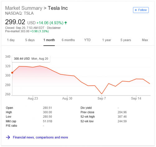

Grey Havoc said:
I'm not so sure. We'll see, I suppose.
All you have to do is look. #ElonPuff happened on Sept 6th.
