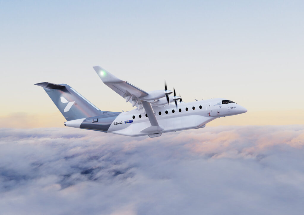

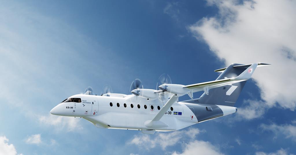

Wow. They are abandoning their 19 seater project and going for a much larger 30 seat aircraft. Projected entry into service is 2028. They likely realized the smaller 19 seat design would have too little range to be practical so they're scaling up. But in my opinion battery density is simply not there yet for a 30 seat aircraft. Some quotes from the Flight article:
"Heart has also revealed two new shareholders, with Air Canada and Saab taking minority stakes in the business."
"Range with 30 passengers on board in all-electric mode is a claimed 108nm (200km), or 215nm using reserve power from two turbogenerators. In addition, range of up to 430nm is possible if only 25 passengers are carried."
This is an excellent 2 part analysis of their previous 19 seat project that is worth a read.
https://leehamnews.com/2021/07/01/the-t ... -aircraft/
https://leehamnews.com/2021/07/08/the-t ... ft-part-2/
OMG that’s one ugly looking aeroplane. Oh Lordy, crash landing on a high power density battery…. Good luck chaps with the certification.
Interesting it’s now hybrid with just a hundred mile electric range and anything on top requires the burning of unspecified chemicals? So believable range but why burn more chemicals transporting a battery, than there’s energy in the battery?

I am pretty sure now that they have no idea what they are doing.
200km range and E-efficient propulsion but they still allocate huge sums of money for winglets and a high performance cruising wing?
Saggy Karman but still they go for a thin airfoil...

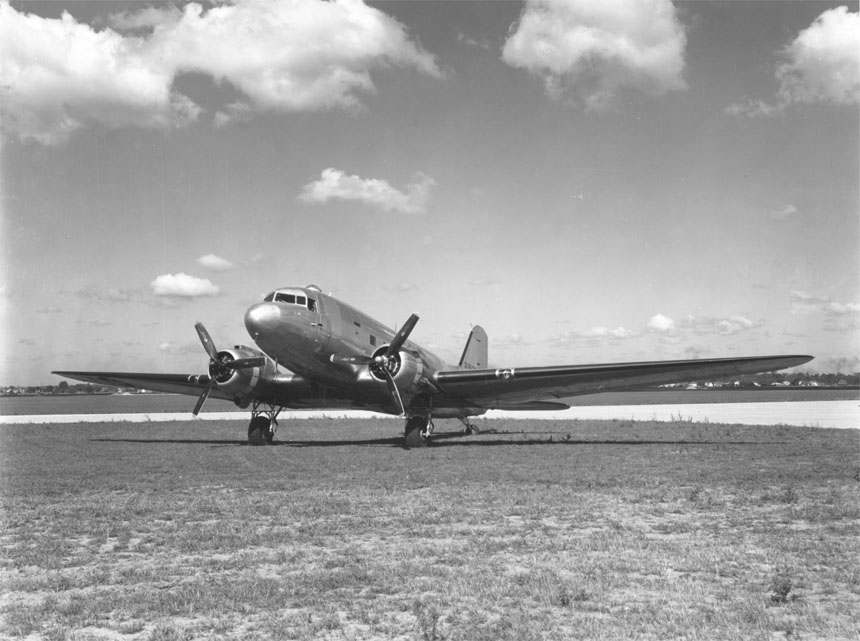

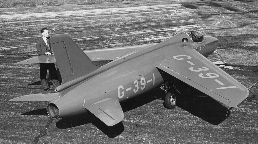

Here is what best suits their requirements:
a thin airfoil
... hat ? as in, thin airfoil hat ? the truth is out there...

As noted already, development of the ES-19 has been discontinued in favour of the larger ES-30:
From the article:
Heart Aerospace’s ES-30 will be more than twice as heavy as the previously proposed ES-19, with a wingspan that also grows by nearly one-third, according to the manufacturer’s preliminary data.
Unveiled on 15 September at a hangar day event at the company’s Save airport headquarters near Gothenburg, Sweden, the 30-seat ES-30 is a hybrid-electric regional aircraft that replaces the 19-passenger ES-19, development of which has now been discontinued.
No longer constrained by the 8,618kg (19,000lb) weight limit of Europe’s CS-23 regulations, the CS-25-compliant ES-30 has gained significant mass over its predecessor.
Maximum take-off weight is now in the 20-21t range, of which 5t is batteries, says head of marketing Claudio Camelier. However, he cautions that the aircraft’s weight and dimensions could still change as it progresses through the design process.
“Once we took the action to move into CS-25 that limit ceased to apply; it has allowed us to look at many other aspects of the airplane to make it more applicable to airlines,” he says.
Wingspan has also increased to 30.77m (101ft), from 23m on the ES-19, while the ES-30’s fuselage is 22.7m long, a 5.2m rise over the smaller aircraft.
Much of that additional fuselage length is required to accommodate a larger baggage compartment and a pair of 800kW-class turbogenerators, which allow range to be extended to 216nm (400km), or 431nm with 25 passengers aboard.
Additional room for passengers has been created by an expanded fuselage, growing from 1.46m-wide on the ES-19 to 2.21m on the ES-30, allowing a switch to a 2+1 seat configuration against 1+1 previously.
Although billed as a 30-seater, Heart is also offering the ES-30 in a high-density 34-passenger configuration, featuring seating with a pitch of 29in in the forward cabin and 30in at the rear.
Other changes include the addition of a wing-fuselage brace and a large fairing below the fuselage that houses the battery packs, rather than in the nacelles of the ES-19.
Camelier says the fuselage-wing brace was required due to the length of the “very high-aspect ratio” wing, which as a trade-off for its improved efficiency “imposes challenges on the structural design”.
Heart has engaged several well-known suppliers such as Aernnova and Garmin on the programme, but has yet to settle on suppliers for crucial components such as the battery pack or 700kW-class electric motors.
Although Heart had been working on its own electric motor it is unclear if these will be used on the final design; indeed, representatives from Magnix – including chief technical officer Riona Armesmith – and Evolito were present at the hangar day.
