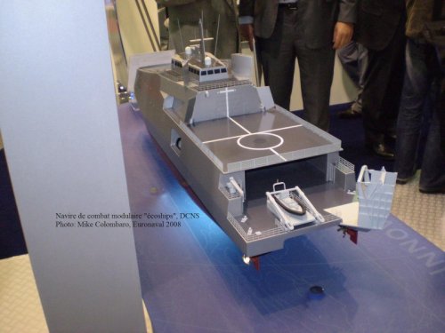

a french study for ecological warships

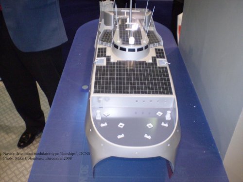

Well, lesseee. As depicted, the warship seems to lack one important consideration: weapons. Just a couple of small guns, no missiles, a helo deck but not much else. That's because most of the deck is taken up with solar cells, which are poor choices for on-demand power, especially in a relatively compact area, and will require lot of work to keep clean (power generation capability falls off rapidly the further you get from pristine).
Fuel savings alone are not a valid measure, its fuel savings vs. capabilities. After all, the maximum fuel savings can be achieved if the ship never leaves the dock and the sailors all have fierce expressions and shake their fists at the foe. I suspect that given the limited amount of power that will be available, there won't be a lot of capability.
...and heaven help it if it encountered any "real" opponent. That white kite might be in big demand after all...
TinWing's observation makes me wonder if this is meant to be an auxiliary of some type, such as a minesweeper like the original Navik or an environmental/fisheries protection or patrol vessel. It would make sense in that regard, and would give such a vessel decent endurance too.

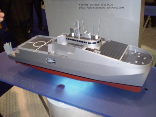

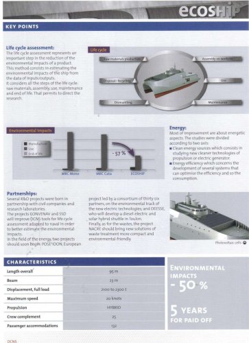

The DCNS "Ecoship" is an environmentally conscious design study to replace the French Navy's five Bâtiment de Transport Léger or BATRAL class light amphibious landing ships. The BATRAL class itself is only 80 m (262 ft) and has a fully loaded displacement of 1,330 tons. It is armed with two 40 mm guns and two 12.7 mm machine guns, which explains why the "Ecoship" appears to be so lightly armed. The BATRAL is designed to ferry 400 tons of material to land a Guépard-type intervention unit (5 officers, 15 petty officers and 118 men), so I presume that the "Ecoship" is designed to carry a similar number of men and material
To save on weight and reduce the size of the powerplant, the "Ecoship" has an aluminum hull instead of steel. A catamaran hull was chosen over a monohull to further reduce the size of the powerplant and to also increase deck space. The ship is powered by a hybrid electric and medium-speed diesel powerplant to reduce fuel consumption and also carbon dioxide emissions. The powerplant powers a cycloidal drive system.
The hull uses silicone-based anti-fouling that is non-toxic.
The ship also has solar cells and the kite sail that has already been commented on.
