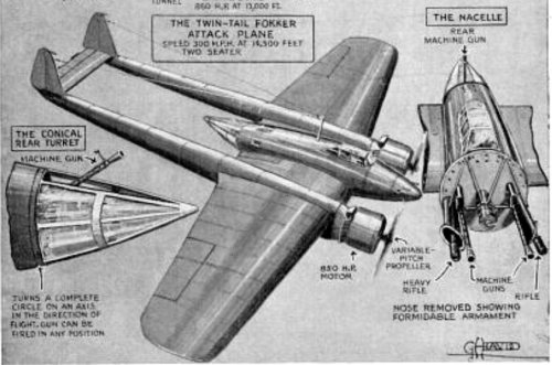

you feel with those artist drawings to Fokker G.1,it was different from we have,
a little.
Jos Heyman
Feb 15, 2007
597
23

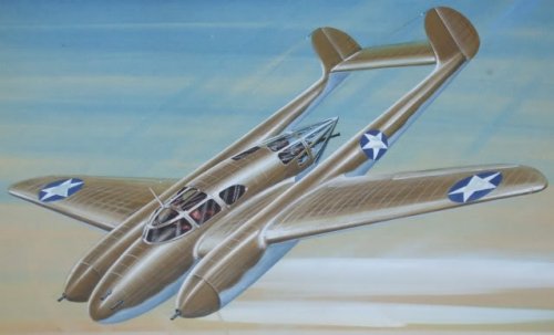

The first drawing is indeed nothing more than an artist fantasy. I am not aware that the US was ever considering the G.1.
The second drawing is, as indicated, a Koolhoven vision and does not belong in this topic. Koolhoven iis definitely not Fokker.

That's always the crux with photos or drawings showing a mix of types. I've made a cut-out
from that "Twin-Tail Fokker Attack Plane" and replaced the other, maybe misleading picture with it.
Nevertheless I'm not sure, if it really is a ground attack version of the G.I, or just an interpretation
made by hearsay.
BTW, is that fancy G.I in US colours from Popular Mechanics, too ?

My dears Jos and Jemiba,
I will ask about the second picture.

Interpretations with much artistic freedom I guess...
Should be interesting to know the timeframe and source..

My dear Lark,
the second picture was an artist drawing to attack version of Fokker G.1,made by
Popular Mechanics in April 1937;
http://www.jitterbuzz.com/MAN_1937_04.html
but I heard that,there is an attack version of G.1,and took the "P" designation,is
that right ?.
For the first picture,I am sorry,I put it wrong from few months as a Fokker G.1,
but it was unknown fighter aircraft,Probabaly from USA,and appeared in the
book; An Airplane in Every Garage,please can we open a new topic for it,it
was not related to Fokker G.1;
http://ehangar.com/forum/your-collection/guss-collection-of-originals/page-4/
book
NO. The site doesn't say that at all.
It says that the artist, known as Ted Grohs, is also known for his work on that 1958 book, which is substantially different.
Stargazer2006
Jun 25, 2009
13,227
713
The 1958 book quoted above was by Daniel R. Zuck, who designed the 1947 Plane-Mobile.
http://www.biblio.com/books/688883135.html
http://www.aerofiles.com/zuck-art.jpg

The Fokker G-1 was a 'jachtkruiser', something that loosely translate as 'fighter cruiser'. I would place it roughly in the same category as the Bell XFM-1 Airacuda and the Martin XA-15 that we have discussed elsewhere.
I do not know what missions the 'jachtkruiser' flew but I also doubt that anybody can properly explain the difference between a 'fighter' and an 'attack' aircraft, other that the first one is supposed to 'attack' other fighters, and the second one is supposed to fight 'ground' operations (pun definitely intended).
As far as the P designations are concerned, I know the Fokker projects were designated with the letter P but there was no P designation for adopted Fokker aircraft designs. A further explanation of the Fokker designations is in Aerofiles.

From 1938 through early 1940, Sweden was negotiating with Fokker to acquire G-1 aircraft. These would have been different from the ones in Dutch service. In Swedish service, the aircraft would have been designated B-7 - 'B' for 'Bombplan'.
In early 1940, Fokker proposed an aircraft that would have carried one 250 kg bomb internally/one 350 kg bomb externally, as well as four 50 kg bombs carried under the wings. A contract had been prepared for 18 aircraft, but was never signed. A follow-on order for 77 aircraft was planned, 12 of which would have been S-13 reconnaissance aircraft - 'S' for 'Spaningsplan'.
Source: 'Fokker G-1 jachtkruiser - deel 1' by Frits Gerdessen, Karel Kalkman, Cor Oostveen and Willem Vredeling, Lanasta 2011.
I think the Swedish aircraft would have qualified as attack aircraft.

Thank you my dears very much,
and for Stargazer,was the twin boom fighter artist drawing a real design or just
a hypothetical ?,someone in that site,suggested the aircraft was from Lockheed,
and developed from XP-38,but we have all early Lockheed Models,also I have all
early "L" and "V" series,and nothing in them.

Well, it's described as "similar to the G.I", so it seems at least clear, that there actually
is no connection to Fokker. There's post suggesting, that it is just a fictional type, as many
details, like inlets or exhausts are missing completely.
a hypothetical ?
This painter did a series of commercial works depicting real types but this is obviously something he did for a company.
The only company that I've seen his name associated with during the 1940s is Consolidated (he did illustrations for them).

Frits Gerdessen & Co in the mighty G.1 book published by Lanasta -The Netherlands, mentions
five versions of the basic G.1. Among them is a ground attack variant.
But for the recce. version with the glazed belly cupola, there are no
external differences in the plane layout for the other versions.
