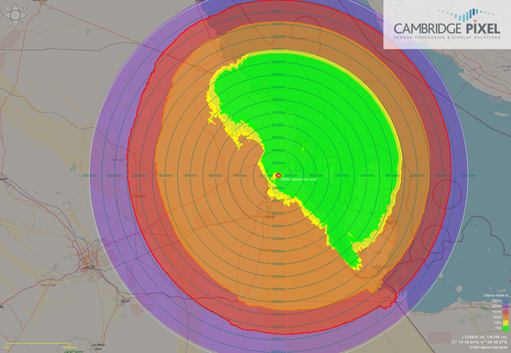

US looking for aerostat air-defence radars for Saudi Arabia
The US Air Force Life Cycle Management Center (AFLCMC) has released a request for information (RFI) for radars that are carried by aerostats to increase their ability to...www.janes.com
Additionally, most of the KSA is empty space with tight clusters of point targets. An airborne defense with a tight point defenses makes more sense. However KSA AD doesn't have a good anti drone point defense system. They would probably benefit from something like M-SHORAD.I think you are right, taking into account the line-of-sight factor and the uncertainty bearing of the target in radar shadowsBorder radars could be attacked directly though, one would need fairly dense SHORAD and other defense coverage. Building a "great wall of AD" across significant distances is probably more expensive than planes that can coverage huge areas each.

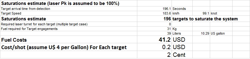

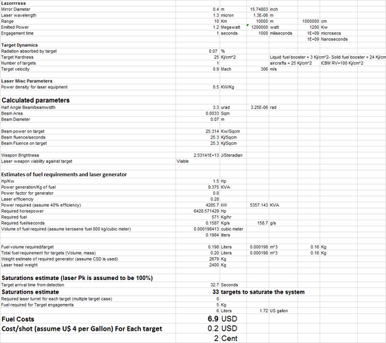

The following is my simple estimates on hypothetical laser weapon a solid state type, with 1.2 MW capability. It has 40 cm mirror telescope. and 10 Km range. It is relatively big... 2.4 metric tonne for the laser head and 2.67 Metric tonne for the required generator. I havent touch on cooling yet but it definitely needs some extreme cooling capability. Assuming 90% of heat removal it would need 1 MW of cooling capacity. The cooling equipment weight can be estimated by converting that 1 MW to KW so it would be 1000 KW and multiply it with 1.36. Thus the cooling system would be 1.36 Metric tonne.
This kind of laser can handle Aircraft with assumed hardness of 25 kJ/sqcm. In 1 second of engagement time. Thus If there is a drone or aircraft or cruise missile move at Mach 0.9. The system can handle 33 of them. With fuel requirements of about 1.72 US Gallon. of 6 liters. Costing about 6.9 USD or 2 Cents per targets.
I wonder what else can be cheaper than that.
The system can cost several millions of dollars maybe... perhaps as costly as modern SAM battery. But if one actually cares about cost per shot... 2 cents for every targets downed.. is a real bargain.
for addition.. Slower drones essentially improves matter.. the second example is drone at mach 0.1 or some 100 Knots. The hypothetical laser system can handle 196 of them. same cost per target. It needs more fuel but 39 liters is perhaps not a big deal.

With about 1 km effective range.. you would need 33 of them to handle the same amount of targets the laser can handle. So the cost will have to be weighed based on how many targets you expect to come. Unlike laser, bullets have limited speed and well... that would means a burst is likely needed and burst can take time. Laser ? 1 second and it's pinpoint, with little to no diffraction. Plus it's deep magazine.
I think a .50 would be effective against a drone at more than 1km?
Laser? 20 million?
.50 with radar etc - the gun would be what 5K? Radar 20K?

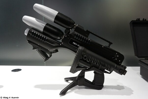

Possibly, I’m also thinking of more environmentally friendly, like nets with little parachutes,fired at them, bringing them gently down to earth.Does the advent of drones bring about the return of large AA guns? A large shell with a proximity fuse would easily take a drone down, especially with modern radar and fire control systems, not to mention that guided shells are now a possibility.
Working as part of a layered approach to counter-drone defense, MORFIUS units will be launched at hostile drones, or drone swarms, and then disable them in close proximity, with potentially a gigawatt of microwave power — or, as Lockheed put it, a million times the power of a standard 1,000-watt microwave oven.

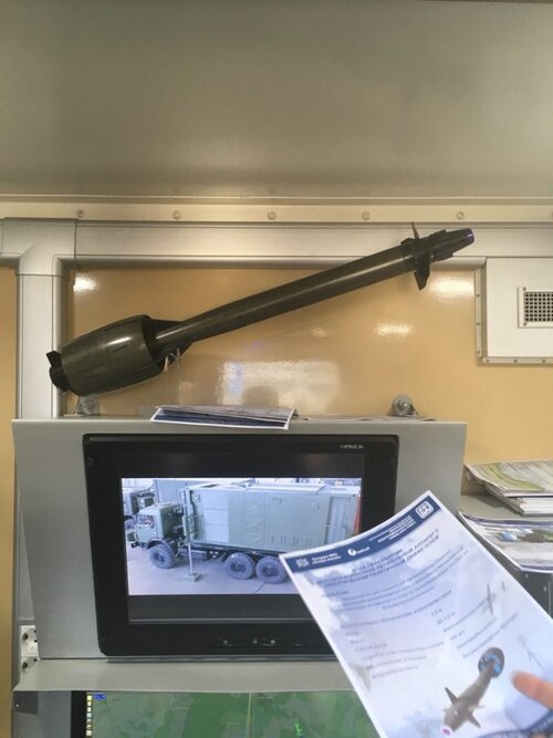

"Тор-М2" получит недорогую малогабаритную ракету для борьбы с дронами
Зенитный ракетный комплекс "Тор-М2" получит новую ракету для борьбы с беспилотными летательными аппаратами. Уже выполняются работы по созданию относительно дешевой малогабаритной ракетыrg.ru
"The Tor-M2 anti-aircraft missile system will receive an inexpensive small-sized missile to combat unmanned aerial vehicles. The Commander-in-Chief of the Ground Forces, General of the Army Oleg Salyukov, told about this in an exclusive interview with the "RG" correspondent .
Speaking about combat and reconnaissance drones, he noted that the Tor-M2 anti-aircraft missile system is the most effective in the fight against them. But the cost of its anti-aircraft guided missiles significantly exceeds the price of small drones.
Therefore, work is currently underway to create a relatively cheap small-sized rocket for this complex. They can be used against drones."
