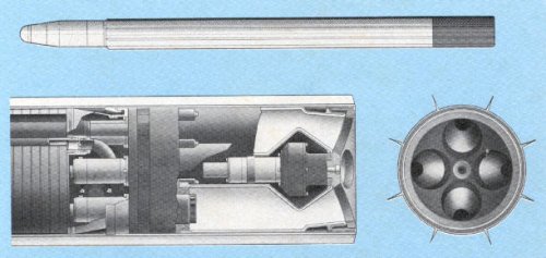

This what Trailleur AAM looked like. Source IDR
Interesting nozzle design there. One comparatively small nozzle aimed directly aft and four canted nozzles that balance through the missile centerline. I can understand the multiple nozzles as opposed to one large nozzle, it makes for better expansion ratios and better performance.
