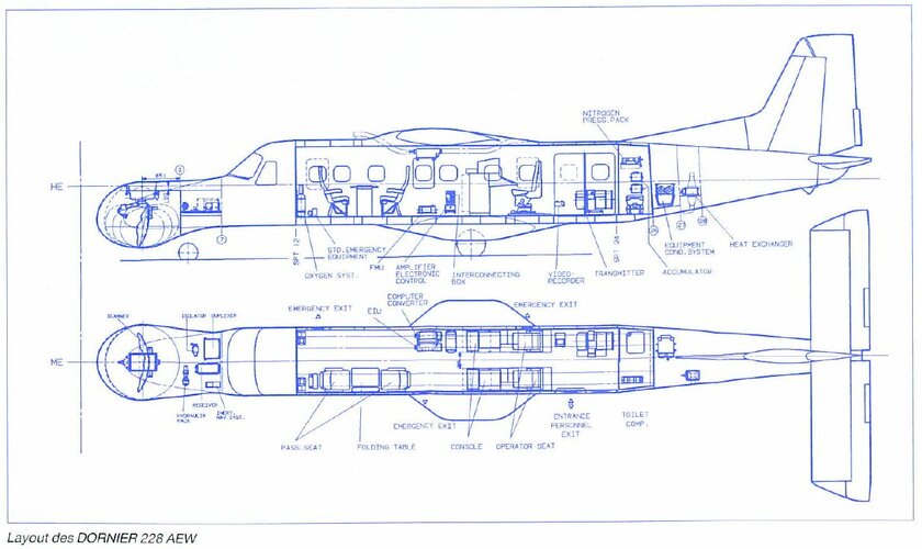

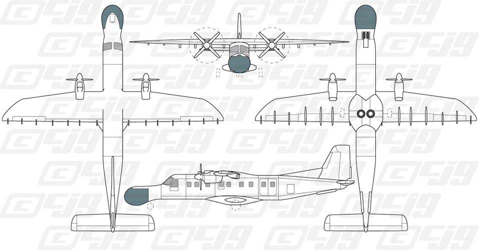

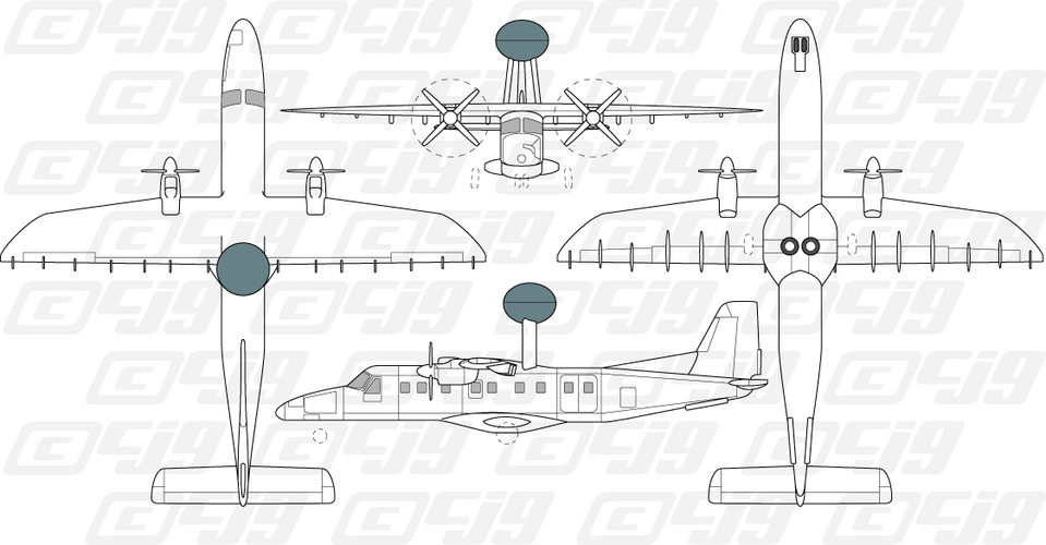

I found an article in the Dornier Post about their ideas for a small, relatively cheap AEW aircraft based on the Do228. The radar they chose was the Thorn EMI Skymaster mounted in 2 different version, either in the nose or in a radome on top of the aircraft.
Do-Post_88-2

Any idea which radar position provided better coverage? Nose mounted looks neater anyway!
Wedgetail type would be the current style but where would that fall in ability/aerodynamic cost?

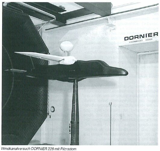

@CJGibson - I wonder if the height of the radome (moment arm I think) and it being behind(?) what appears to be the aircraft CG might create some stability issues. A wedgetail might be better aerodynamically, but I think there might be a significant weight penalty associated with it.
That spherical widget looks like it would introduce a pitch up tendency.
Looks very ripe for von Kármán vortex street or von Kármán vortices. Couple that with a nearby airframe resonance mode, and you will very soon have a load of scrap aluminum flying in close formation in a descending trajectory.

I might have a go at the Pilzradom next.

That bulbous nose radome reminds us of a similar installation on a British Army Britten-Norman Islander/Defender. The Islander needed an extended nosewheel strut to prevent the radome from dragging on the runway.
