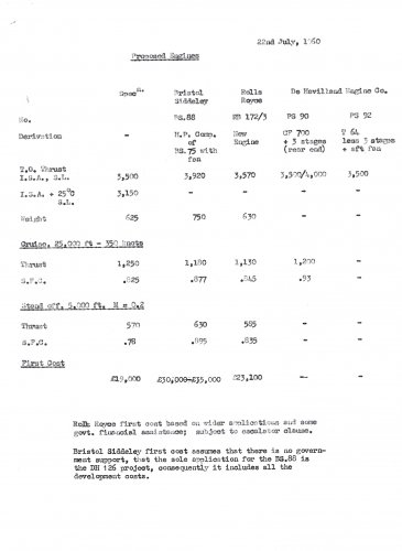

Proposed turbofans engines:
Bristol Siddeley BS.88
Rolls Royce RB 172/3 (new engine)
de Havilland PS 90
de Havilland PS 92

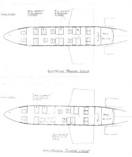

A navigational trainer version is also described and illustrated with 2 crew, 1 instructor, 2 pupils, 4 passengers plus navigational equipment as a potential Valetta replacement.
An electronic training configuration (2 crew, 1 instructor, 4 pupils, 4 passengers) is also shown as a drawing.

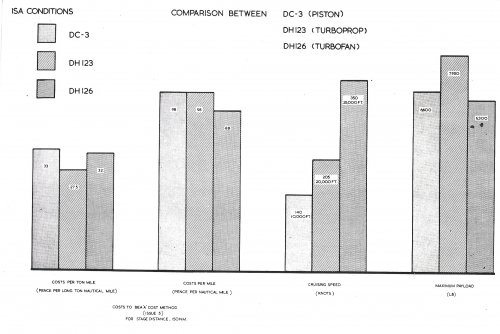

The document also compares the DH126 with the DH123 project in its payload/range, operating costs, work capacity and speed graphs.

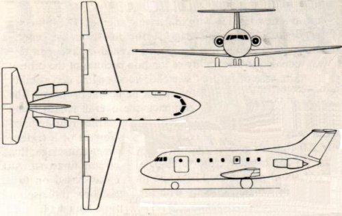

Here is a drawing of the DH-126. I think it appeared in an early issue of Air Enthusiast but am not 100% sure.
Jos's layout fits in with the cabin configuration in the DH document.

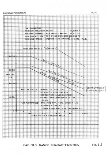

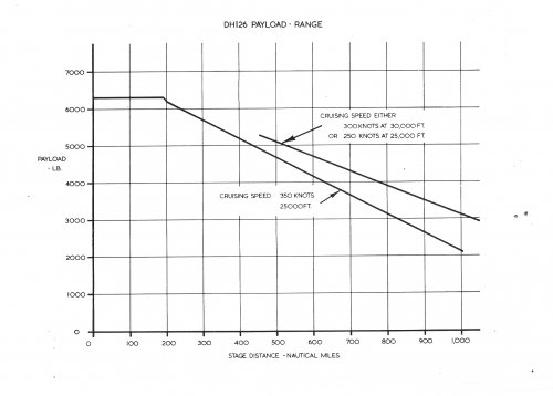

Also attached are a series of scans showing:
· Comparison payload and range characteristics of the Avro 748 Series 2, DH.123, DC-3 and DH.126.
· DH.126 payload and range at cruise speeds
· Comparison bar graphs for the DH.123, DC-3 and DH.126.
· A statement showing the various engine options together with costs.

Finally, the military configurations layouts for the electronic and navigational training versions of the DH.126.
Envisaged to replace the Vickers Varsity and Valetta.
