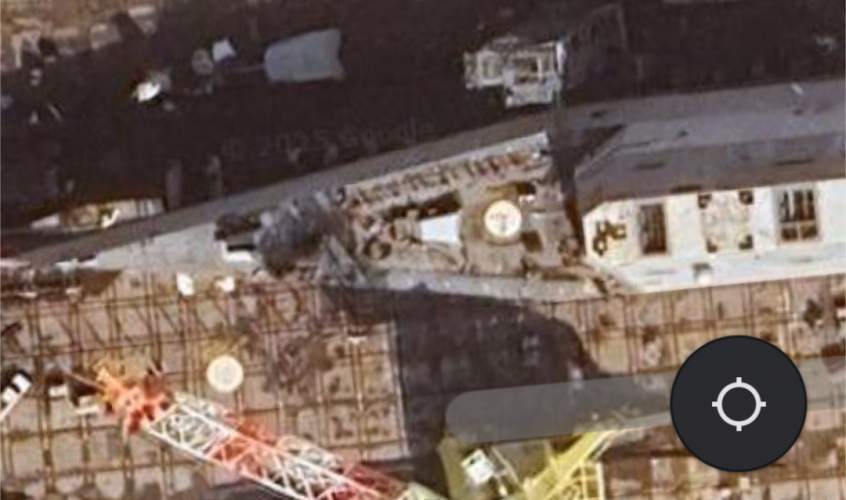

It was just the A turret that was removed. The B turret and AGS handling equipment remains. That's probably a weight thing.
Nope, just the B turret's non-rotating barrel shroud is left.
I stand corrected.

Both turrets are gone on Zumwalt. Not fitting a second set of MACs is probably down to budget and the expected procurement of CPS missiles rather than volume.
Image from Google Maps.
If they're not going to put MACs they should add some Mk41s. The USN being the USN though they'll probably just leave a vast area of empty deck.
