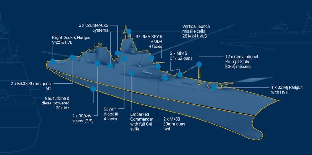

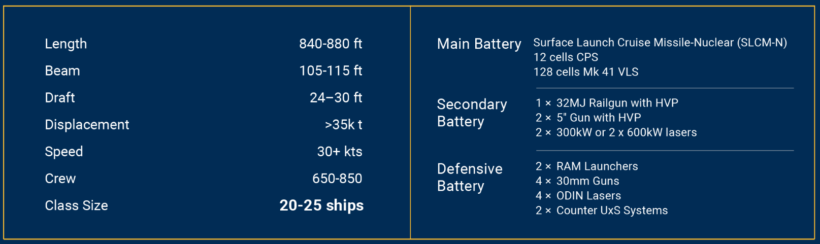

Most places seem to have interpreted it has meaning "12 individual cells each holding one CPS missile" -- which would equate to the equivalent of four Advanced Payload Modules/APMs (each of which can accommodate 3 CPS tubes, or alternative 7 Tomahawk sized weapons).
Given some of the art, based on the size of the real estate on the bow section 12 total cells for 12 CPS missiles looks much more reasonable than 12 full APMs.
In at least one of the "infographics" they have, they are somewhat explicit about describing it as "12x CPS missiles" (though of course that infographic does have some typos, namely the Mk-41 VLS should be 128 rather than 28 -- but the 12x CPS missiles part isn't something I could see being a typo in the same manner).
And the "spec sheet" is also calling it "12 cells CPS" specifically...

At this stage I think it's reasonable to interpret that they're referring to 12 total CPS missiles onboard, rather than 12 APMs (which would be 36 CPS missiles).
The "relatively" low total VLS count (for this ship's size) is a likely tradeoff for the pursuit of a large bow railgun and two (bow 5 inch guns. Whether wanting such a heavy gun armament is wise is another matter, but it explains where some of the tonnage went.
