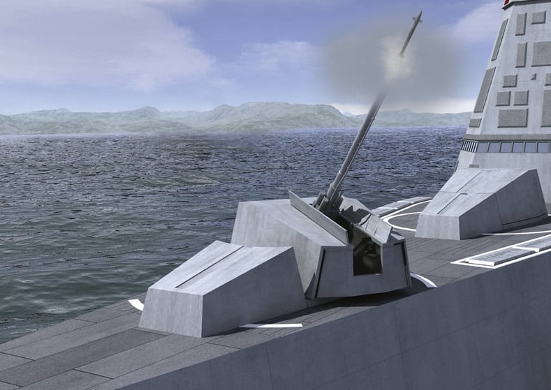

the Test one they have on the M110 chassis out in White Sands apparently shots Excalibur and PGK munitions just fine in tests.The Guntube in the turret is fine, it actually can shot standard 155 shells.
Can it? I've heard several times that the rifling and chamber are not compatible with Army 155mm ammo. It's definitely not a Quadrilateral Ballistics MOU gun.
So they either can and the loader fuck or the change up the bore design between the test piece and the ship mounting.

The quote crosses up Excalibur and HVP but the basic point remains. The AGS tube cannot readily accept other ammo besides LRLAP.
What remains now is how much additional engineering work it will take to modify the existing AGS to accommodate the Excalibur. The AGS barrel and the accompanying automatic ammunition handling system were specifically designed to handle the LRLAP.
“It’s a unique barrel for this ammunition. It’s a six-inch round designed with the turnings to allow the LRLAP to fly out of that barrel. There’s been some studies over the year that [indicate] that you could but you’d have to undertake a modification of the system,” then DDG-1000 program manager Rear Adm. Jim Downey told USNI News in May.
“It’s not impossible but you can’t directly fire [hyper velocity projectiles] out of that barrel without modifications.”
