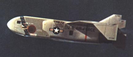

Is there some expendable weapon that uses that engine I am not aware of?
During the 1970s the U.S. Army updated some of their MQM-34Ds for use as targets for FIM-92 Stinger man-portable SAMs, refitting these drones with a General Electric J85-GE-7 turbojet of 2,500 lbf thrust which were salvaged from old ADM-20 Quaildecoys. The modified MQM-34Ds featured a revised forward fuselage with a circular nose intake that gave them an appearance similar to that of a "stretched" first-generation Q-2A target, and were given the designation of MQM-34D Mod II.
Quail?
Quail?

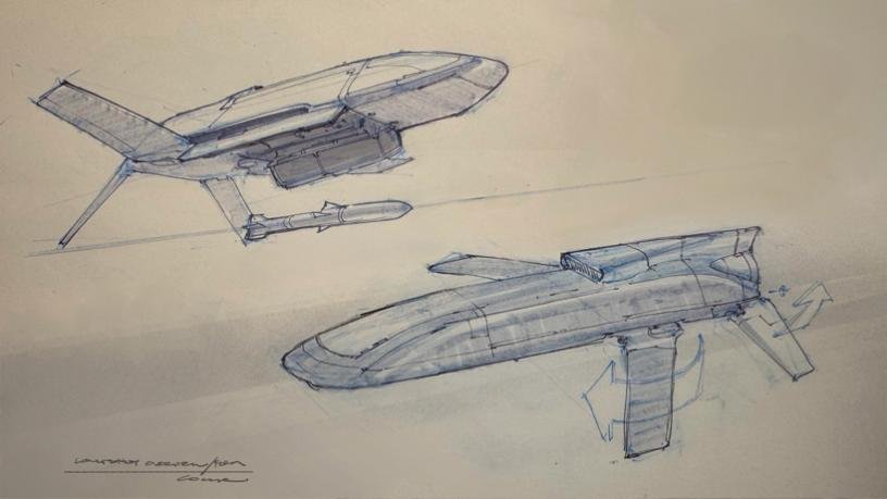

For the configuration, we can see there that it was chosen to deal with the large variation in CG during the mission (something we have foreseen early when the RFI project was revealed. So, we should not eventually be surprised if we learn ultimately that LongShot is recoverable (at least during the less stringent firing conditions).
Keeping the launcher stable during the firing process is probably still important even if recovery is not a goal. If nothing else, you might want to fire AAMs individually.
I don't think the B-21 has side bays. I used to, but I don't now. Or rather, the bays between engines and centerline bay are avionics and Environmental Control systems, cooling etc.Notice also that the form factor would probably fit in B-21 side wb.
Agreed.Those bays are not for missiles - that was clear from the maiden flight.
Sheer size. A Longshot carrying 2x AMRAAM-Cs needs to hold 2x13" boxes, though the boxes can overlap some. You're looking at an overlapped box in the neighborhood of 24"x13"What prevents you from thinking that Longshots can be used from rotary launcher substituting one or two ALCMs/LRSOs?
