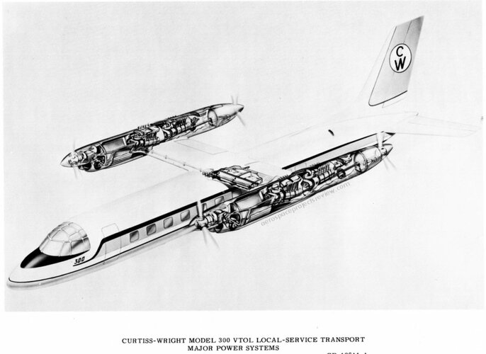

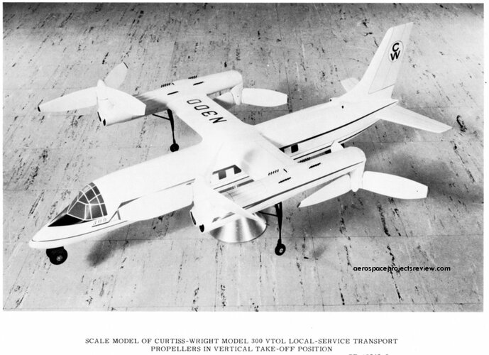

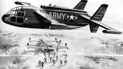

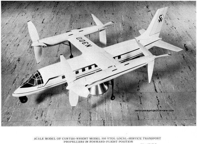

the Curtiss Wright X-300 was developed from X-200 as 40-passenger
vtol aircraft employing gimballed propellers and more powerful engines,
the X-300 differed from the X-200 in that the four engines were to be
mounted in two nacelles-two pulling and twp pushing,VTOL performasnce
was to be achieved by gimballing the rear pusher propellers downward
90-degrees as the forward propellers were rotated upward.
from 'the Curtiss X-Planes', schiffer,
cheers,
Robin.

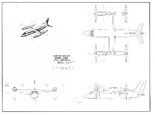

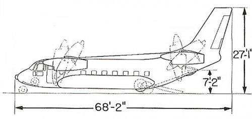

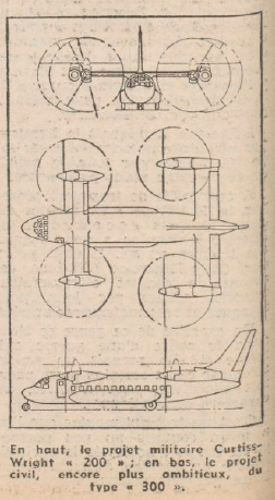

no information on X-325, but Model 300, 410, and 425 were all 4 engined tilt prop transports, of differing sizes and weights, as below,
all information from 'the curtiss x-planes'
model 300 length 73' 10" span 63' 6"* max. weight 54,500lbs
model 410 length 67' 11" span 65' 6"* max weight 56,700 lbs
model 425 length 68' 2" span 66'* max weight 62,400 lbs
* includes propellor disc.
cheers,
Robin.

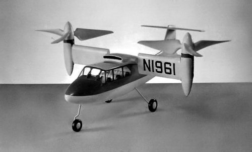

the model 207 was a utility transport design using the wings, tails, engines, and transmission from the model 90, curtiss' submission to the AAFSS requirement, mated to a new fuselage.
design gross weight was 24,400 lbs, max true airspeed was 375 knots at approximately 10,000 ft. hover cieling at design gross weight was 12,000 ft, or 8,000 ft in hot conditions.
range was 380 miles at design gross weight with a 3000 lb payload.
source as before, 'the curtiss x-planes' .
cheers,
Robin.

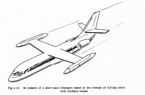

here is a drawing from DTIC,looks like Curtiss-Wright X-300 design,
but it has one folding tilt-rotor.
You're missing the BIG difference here... this one's got tail-mounted jet units!!

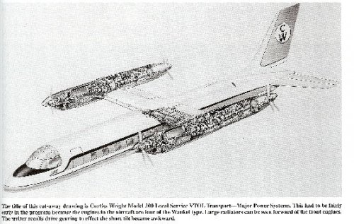

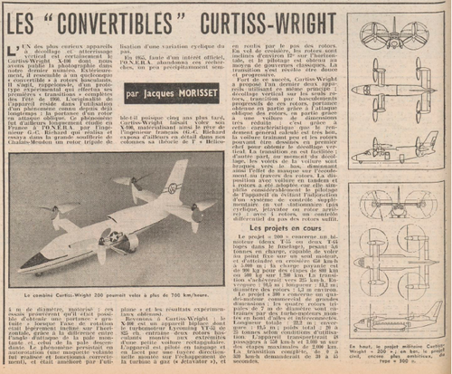

From Ailes 2/2/1962,
the Curtiss X-300.

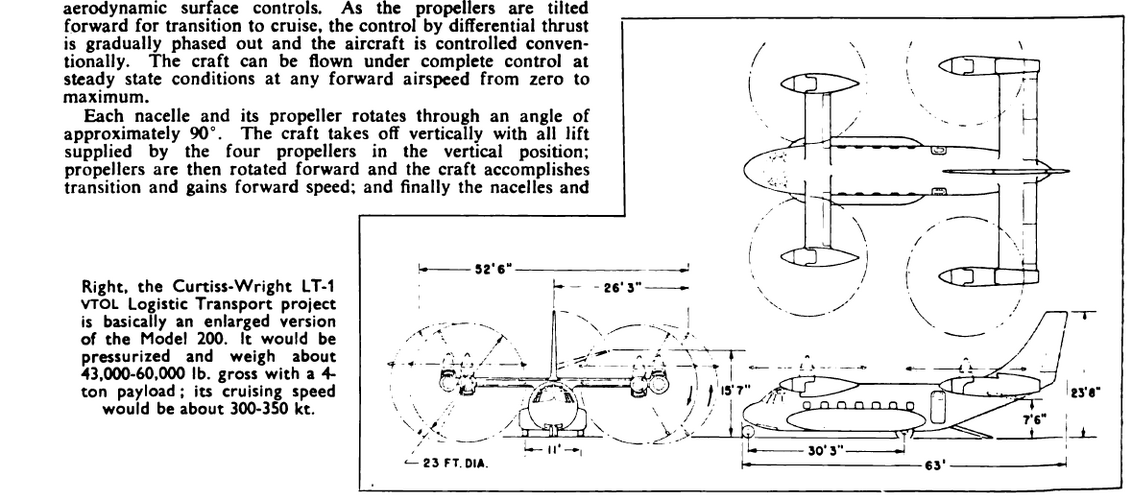

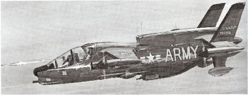

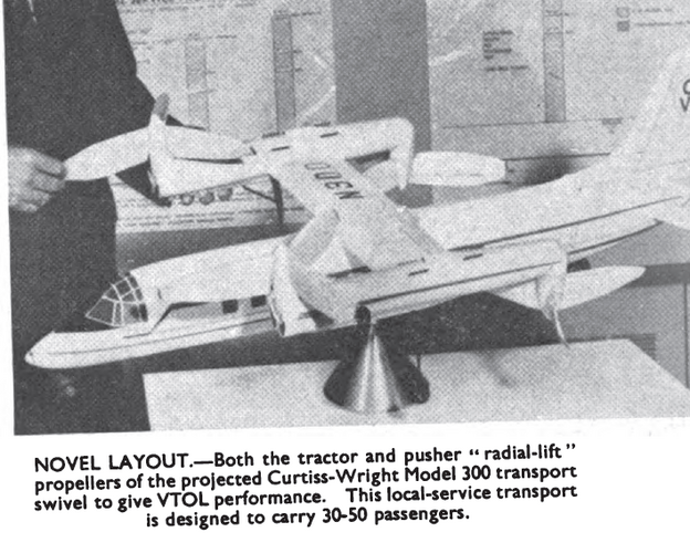

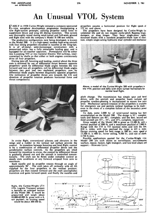

It's interesting that the engines were initially intended to be of the Wankel type (more than likely planned to be built under licence by Wright Aeronautical, which was a division of Curtiss-Wright).
From Aeroplane 1961,
the Curtiss-Wright LT-1.
