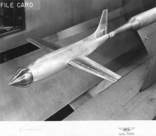

Bell X-1 model with supersonic spinner.
https://crgis.ndc.nasa.gov/historic/Test_104:_X-1_Model
