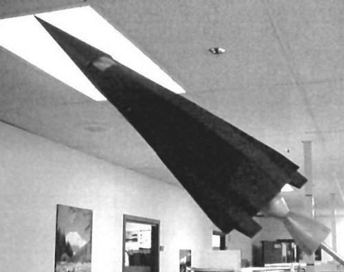

Or this is not the entire design? Maybe there is still a booster (which doesn't be integrated this time) and this is just the second stage?

sferrin
CLEARANCE: Above Top Secret
Jun 3, 2011
12,892
966
Maybe that thing that was shown on the B-52 is only the upper stage of the missile.
Forest Green
CLEARANCE: Secret
Jun 11, 2019
493
157
I have a feeling it is the whole thing having read about ArcLight. If a 6.5m long 533mm missile can deliver a 90kg warhead 2,000nm, then the same missile increased to 800mm diameter can probably carry a 200kg warhead the same distance and if you can carry a dozen of them, that helps target saturation.
Although, it would make some sense to maybe base a longer range weapon around the same final stage. 20,000lbs is enormous though. A Pershing II was only 16,500lb. HCSW is supposedly bigger than ARRW though I thought.
TomS
CLEARANCE: Top Secret
Apr 16, 2008
3,631
520
Incorporating only the upper stage would make absolutely no sense for a carry test. Not having part of the missile body attached would completely invalidate any aerodynamic or vibroacoutic data collected during the flight. Also, why would the suspension lugs be on the upper stage?

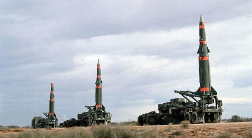

Why fly a Pershing II like this:
TomS
Apr 16, 2008
3,631
520
That's not a Pershing II, it's a Pershing Ib, which was originally developed as a limited range version for the German Air Force to comply with SALT II. (The US also used them for some testing due to range limits at White Sands.)
It represents an actual operational configuration for Pershing, and would have required some separate testing from the Pershing II, because it was a different weapon in important ways.
Leaving off the booster in a captive-carry test of an air-launched missile would only make sense if the upper stage alone was an operational configuration. That seems unlikely in this case.

Yes, I knew it was an actual configuration (though no idea if they actually deployed any like that). That was kind of my point. I'm not necessarily claiming the shape shown on the B-52 has an additional booster. I was speculating that maybe it does. (Or else there's some other 20,000lb weapon in mind.)
