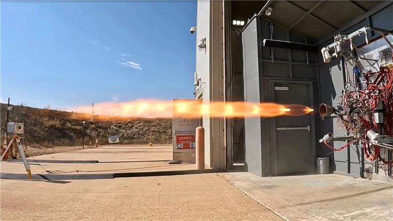

What do they mean by a "Highly loaded grain"?
Typical SRMs use a Center Perforated (CP, hole through the center of the cylinder) grain as the configuration of the propellant you’ll also hear finocyl used to designate a star pattern in the CP. This configuration is typically limited to 80-90% volume loading on large motors, less for smaller diameters. The concept of highly loaded grain is to go beyond that typical design scenario. Basically, trying to stuff more propellant (ie, motor impulse) into the same volume.

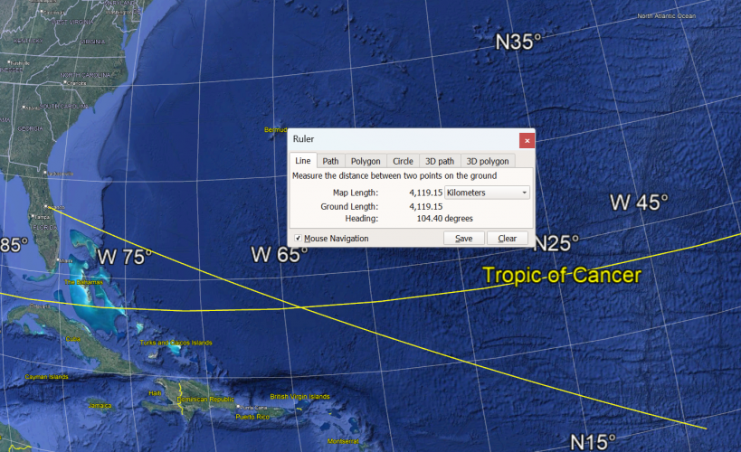

That’s an interesting NOTAM…it looks like two separate trajectories might be used? Perhaps weather dependent?
Or two missiles, or two warheads on one missile???
What's interesting is that assuming the launch from Florida, the glide range seems to be more than half the total range (>2,000km). Perhaps this is the more advanced boost glide vehicle for the Dark Eagle.
Is there a second type of glide vehicle known to be in development? Otherwise I would just assume a longer glide range was a test to see how stable the vehicle is at slower speeds, possibly down well into supersonic.
