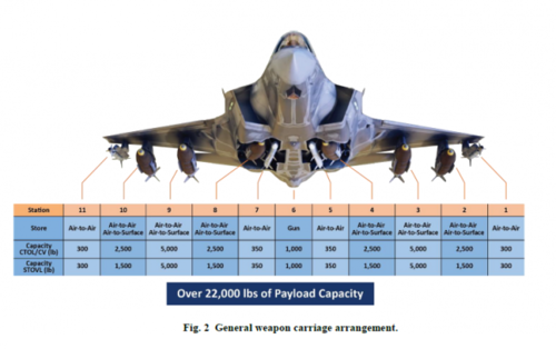

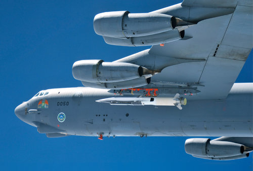

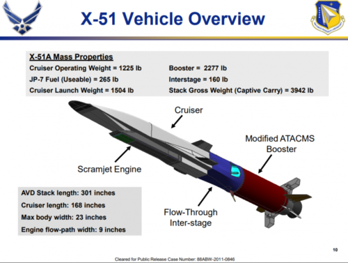

X-51 wave rider is surprisingly light, only 3942 lbs which is 1000 lbs less than the load limit of F-35 inner station
Could the same hold true for AGM-183A? it does look fatter and shorter than X-51
I'm sorry but I don't quite grasp your logic. What warhead did the X-51 carry? What sort of seeker or guidance system? How does any of that compare to the AGM-183A which is actually designed to go out and destroy a particular target set?
you are right, that was dumb of me :(
