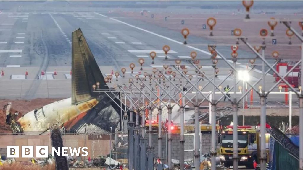

What ultimately doomed the occupants of the 737 is that massive concrete wall at the end of the runway, my understanding is that wall should never, ever have been placed there (Someone is going to catch it hot over that concrete wall).
That wall is to house the Instrument Landing System antennas. Which are required to be in that location for correct operation. It is some 500m away from the runway overrun.

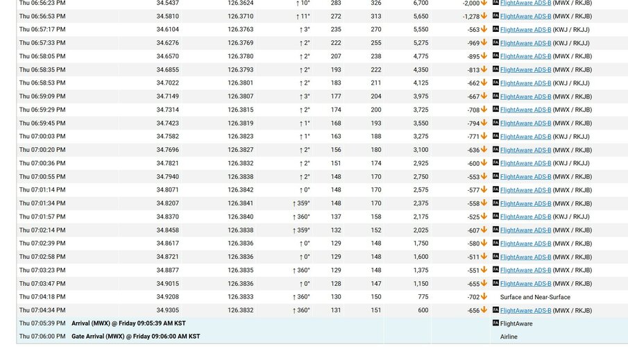

Flightdata.com has track data through 0657. (excerpt below). Interestingly, no data seems to have been received post 0657, yet we have reasonably reliable accounts that the aircraft subsequently maneuvered to land in the opposite direction. What I can find in news account is the pilot reported a bird strike at 0658, and the aircraft touched down at 0703.
Not personally a pilot, but have flown enough to have some idea what normal looks like on a 737, and fairly easy to compare to the previous day's flight. I don't have the experience to say what normal speed/decent rate looks like for this airport/aircraft, but comparison to a similar flight seems reasonable. What jumps out to me though is the magnitude and variability of the decent rate just before the cutoff. The last point seems to correspond with the engine loss, so a high rate there is reasonable, but 0655-0656 is well prior. Comparing to the previous day, this is significantly high, and confirmed by this page - "Maintain a constant rate of descent (sink rate) between ~600-800 ft/min;.... Not have a descent rate greater than 1000 ft/min"
It also seems like the airspeed is too high throughout; for instance, 177 vs 156 kts @3000 ft and 144 vs 129 kts @1375 ft.
Admittedly, I'm assuming the data is correct, but this seems reasonable. It is also not my intent to jump to pilot error - there are undoubtedly possible valid reasons for this.
However, it does suggest there was something possibly going on prior to the bird strike or potentially pilot performance shortfalls; notably the flight was apparently late, and maintaining speed until the last minute could be a decision made in an attempt to regain schedule (though I'm unsure how much room there would be for pilot aggressiveness within ATC directions). This could also correlate with keeping flaps at minimum extension.

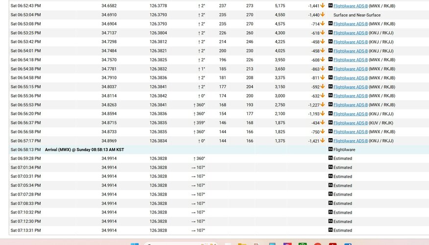

The time between bird strike and landing is of some interest. Single engine takeoff capability is a standard design requirement for any commercial twinjet, and further the design criteria is likely more stringent that the actual condition of JJA2216 (certification required at maximum takeoff/landing weight, and likely at higher temperature/elevation). Consequently, there is every reason to believe the aircraft should have been able to fly reasonable well even with an engine out; this is demonstrated by the fact that it did continue well enough to pass the airport, reverse and line up for the reciprocal landing. This fact also indicates the control system was working reasonably well; the aircraft is clearly well aligned and on runway heading.
Also, again from the 737-800 link above, normal altitude to lower landing gear is 2000-2400 ft, with 15* flaps simultaneously, and landing flaps >1500 ft elevation. Consequently, the aircraft arguably should have been fully configured for landing at the time of the bird strike, and landing gear should have been lowered well prior.
I have some difficulty coming up with a scenario in which a technical problem would result in this series of events. Procedural or technical problems could certainly result of both engines or a loss or aircraft control, but the post incident maneuvering and quite accurate alignment with the runway for landing indicate that power and control were both maintained to a significant degree. Conversely, failing to lower the landing gear, lack of flaps/slats, landing at overly high speed and most of the way down the runway and lack of speed brakes are difficult to ascribe to a mechanical issue. In all likelihood there was a complex error chain, but I suspect a large share will come down poor pilot performance.
