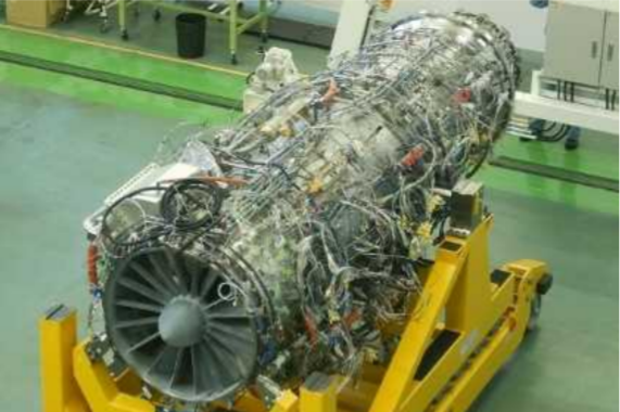

Maybe one of our Japanese members can add what is known about the XF9-1?
EDIT: forgot to add a comment on the EJ200 war setting - this is claimed by various sources, including the old typhoon.starstreak.net site (I have found a reference in a news article too though). Stated to be 95kN.
XF9-1
DesignationLayoutMass Flow kg/sComp RatioBypass RatioWeight kgInlet Dia mMax Dia mLength mTET KDry Thrust kgfA/B Thrust kgfSpecial ThrustSFC CruiseSFC MilSFC A/BEngine Life h
XF9-13/6/1/114.8021001100015000
sources
unfortunately thats about it.. i checked around and these are the same 5-6 info being spread around.
another site on the engine listed this. lots of NA
・形式:アフターバーナ付低バイパス比 ┃
ターボファンエンジン        ┃
・最大直径:N/A            ┃
・空気取り入れ口直径:約1m    ┃
・全長:約4.8m            ┃
・重量:N/A             ┃
・圧縮機:ファン3枚・圧縮機6段    ┃
・燃焼器:アニュラ型          ┃
・タービン:1段低圧・1段高圧タービン ┃
・推力:11t(108kN)ー15t(147kN)以上  ┃
・タービン入口温度:1800度以上    ┃
・推力重量比:N/Aは
The reference is from an article by a Saturn designer, who specifically said they wanted to learn from the French. Now, what they wanted to learn might not be applicable to AL-41F, but it might be.
If the source does not spell out what specifically Saturn was hoping to learn, I would assume the lessons applied mainly to peculiarities of the commercial airline operations environment. This is a topic a CFM participant would certainly be able to teach a thing or two about and not something to which Saturn had much useful exposure of its own. Perhaps also lean manufacturing using modern CAM equipment. By contrast, the classic performance parameters we are tabulating here are an area where Russia has been consistently ahead of France for some time, and especially so with respect to military engines.
・タービン入口温度:1800度以上
Going by Google Translate this is the target for TET, so about 2100K (according to the MoD pdf 1800 is in units of Celsius).
・タービン入口温度:1800度以上
According to Google Translate this is the target for TET, so about 2100K (similar to Izd. 30).
thanks, have updated!
im actually wondering what engine Japan should use in their next aircraft.. continue working on their domestic engine, adopt what the British are using, or combine both?
