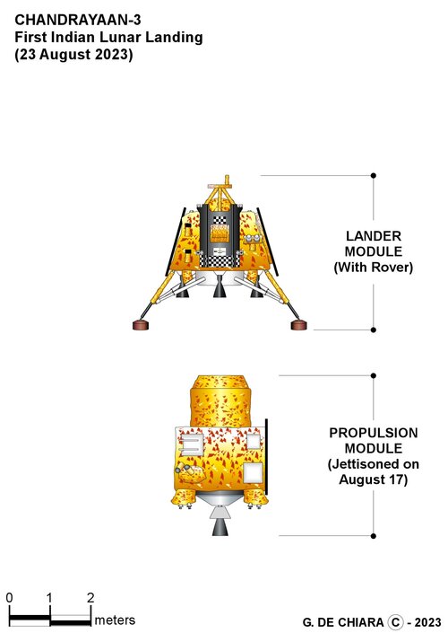

Chandrayaan-3 interplanetary mission has three major modules:the Propulsion module, Lander module, and Rover. The mission's complexity calls for establishing radio-frequency (RF) communication links between the modules.
