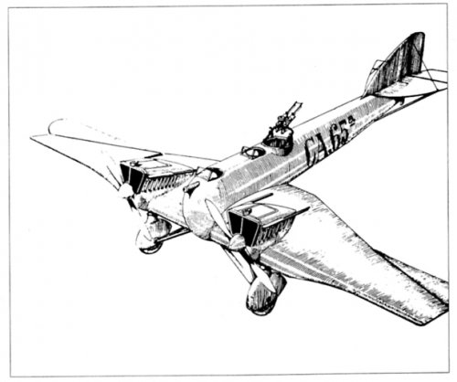

Unbuilt 3 seat heavy fighter project from 1922/23. Offered in versions with radial or in line engines. It was armed with 3 guns.
Source: Rosario Abate, Gregory Alegi e Giorgio Apostolo, Aeroplani Caproni. Gianni Caproni ideatore e costruttore di ali italiane, Museo Caproni, 1992
Looks err unique? Interesting wing/fuselage configuration for a fighter. I wonder if there any other drawings exists?
Could be very interesting so see more data about this aircraft: dimensions as least ?
The wings and undercarriage looks like a bigger version than the one in the ca.64 fighter.

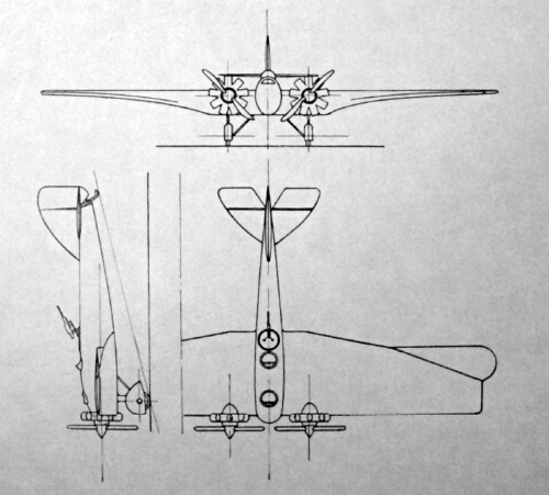

Hi.
Caproni CA-65 3-view from AEROFAN
Juan.

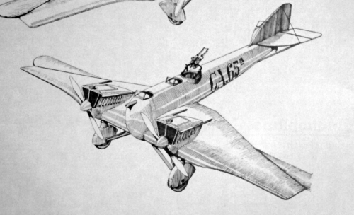

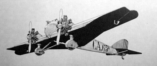

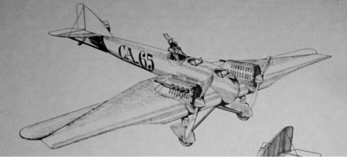

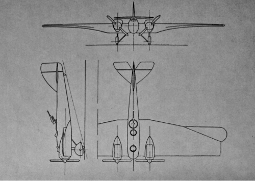

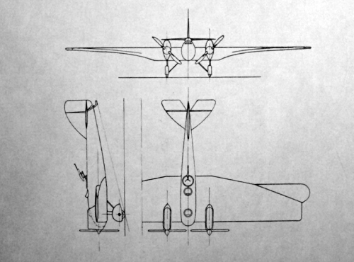

From the design of the Ca.65 born also 2 different projects, both never realized, named Caproni Ca.65a and Caproni Ca65b.
Here some pics, always taken from the book "Gli Aeroplani Caproni": (The first 2 are of the Ca.65a, the seconds are of the Ca.65b)
Lucas thanks a lot for the drawings, I'm very interested on this plane. Muchas Gracias ;)
Do you have any detail of the engines on 65a and 65b projects?
I'm sorry but in my source there are very few info about the Ca.65 and all development. Nothing is said about the engine and the technical data only explain the purposed powers and dimensions...

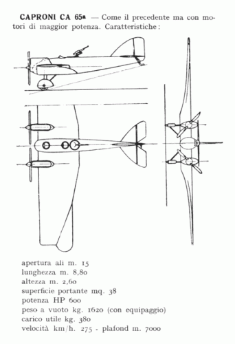

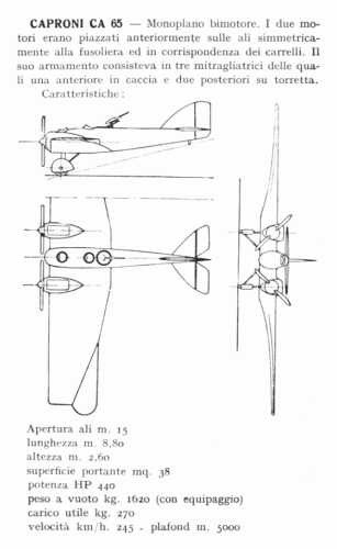

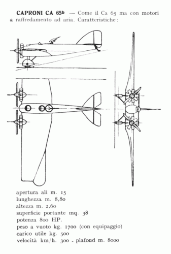

More on the Caproni Ca 65 (there were three versions):
airman said:
from which source is these ?
A very old Italian book entitled I Cento Aeroplani Caproni - 1909-1930, by T. L. Barbero, published by Aeronautica.
