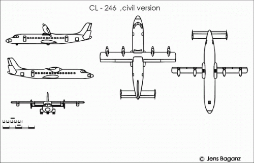

About the Canadair,there was two projects mentioned in the Jane's all the
world's aircraft,CL-212 & CL-246 but with no details,do you know them?.
[NOTE: CL-212 was an air-cushion vehicle. It is now in a separate topic here: https://www.secretprojects.co.uk/forum/index.php?topic=30475.0 — Mod.]

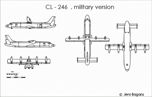

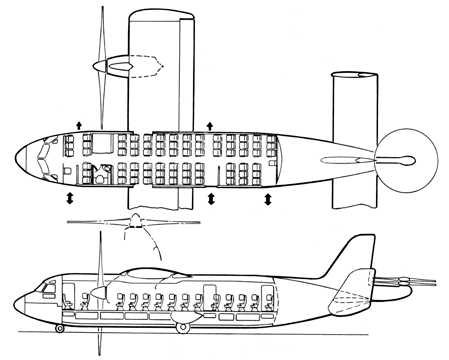

The CL-246 was a 4 engined tilt wing, proposed in a military
a civil version.

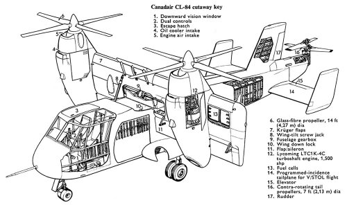

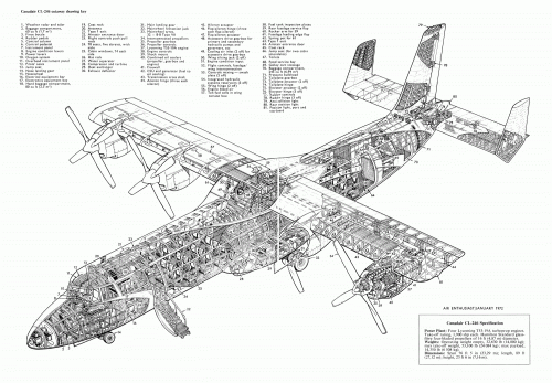

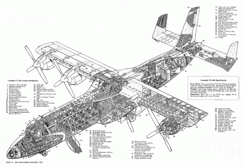

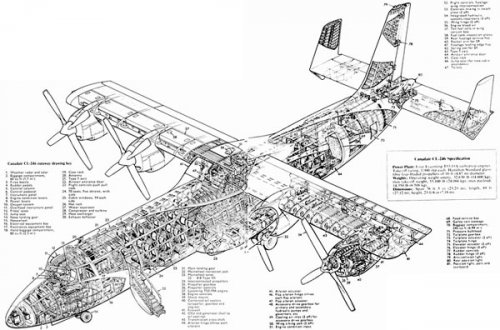

As promised long ago, here is the CL-286 CL-246 cutaway from Air Enthusiast (Vol2 No 1, Jan 1972).
[NOTE: This is actually a cutaway drawing of the CL-246. — Mod.]
600 pixels can't do the drawing justice but you get the flavour of it. :)
... and CL-84 cutaway.

Here's the CL-246 cutaway in a larger size....
Enjoy the Day! Mark
The CL-246 was a projected 70-passenger STOL transport that Canadair projected in 1970. It embodied the technology developed and demonstrated with the earlier CL-/CX-84 Dynavert prototypes. Powered by four 1,900 shp Lycoming T53-19A turboshaft engines, it was designed to operate from the 1,800 ft (548 m) runways proposed then as an STOL-port standard by the FAA.
Since this project is mentioned in various sources but doesn't have its own topic, I have elected to regroup here all that appears in various places elsewhere.
index.php

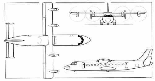

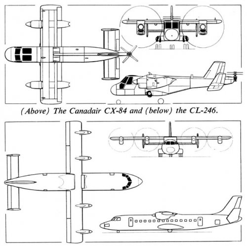

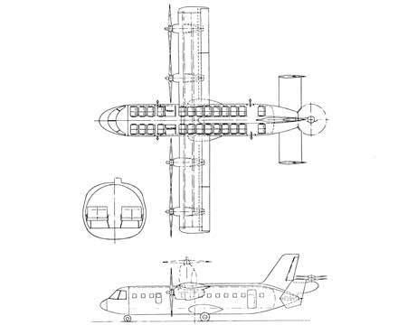

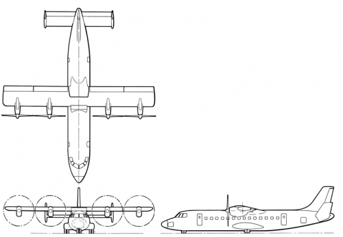

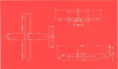

Oriented towards STOL passenger airliner operations initially, Canadair decided to proceed with the advanced Variable Incidence STOL general concept, with the tilting wing technology of the CL-84 at its core, all incorporated into a new aircraft layout, and assigned it the Canadair model number CL-246.
In all respects a tilt-wing aircraft, the CL-246 embodied the variable incidence nomenclature to reflect the limited wing tilt available as compared to the CL-84 and its contemporaries. Whereas the fully tilting wing of the CL-84 allowed the propellers to act like rotors providing a vertical slipstream for VTOL applications, the wing tilt on the CL-246 was to be limited to a maximum of 30 degrees of incidence. Fifteen to eighteen degrees of incidence was envisioned as nominal for standard STOL operations. Originally, a fully tilting wing arrangement was proposed, with the accompanying tail rotor arrangement for longitudinal control, however this idea was eventually dropped as a panacea to some potential passenger’s concerns about their viewing out the windows, and seeing the wing and engine tilting up and away, out of sight.

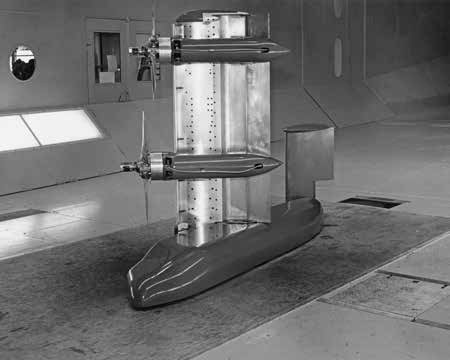

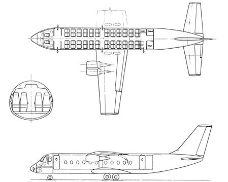

With test model data, and much practical STOL performance and low-speed handling experience gleaned from the flight trials of the CL-84 prototype, and later with the first CL-84-1 aircraft, Canadair was encouraged in 1970 to enter the competition being conducted by American Airlines. The formal Request for Proposals (RFP) for the 48-passenger configured aircraft was issued in September 1970, and the Canadair response was given the model number CL-246-1A10. This new aircraft layout had a pressurized cabin with four abreast seating, carrying all of the necessary operational equipment required for the short haul commercial role, using the engines, propellers, gearboxes and control systems based on the CL-84. With a calculated gross weight of 17,781 kg (39,200 lb), flying at a cruise speed of 316 knots (585 km/h / 129 mph), the design range was to be 648 km (350 nm) plus reserves for a 185 km (100 nm) diversion with 45 minutes in the holding pattern.
The overall fuselage length of this first design was 18.8 m (61.6 ft), with the slightly flattened oval shaped fuselage being 2.8 m (9.1 ft) at its widest. The overall height was 5.9 m (19.5 ft) at the tip of the central vertical fin. The rectangular shaped tilting wing, with an area of 53.9 m² (580.6 ft²), had a span of 20.0 m (65.8 ft), and incorporated single slotted flap / ailerons. The horizontal tail, fitted with twin vertical endplates, rotated in concert with the wing tilt during the small transition phase.
Other Advanced Design department concepts were also being studied at this time including a 48-and 80-passenger turbofan powered STOL aircraft, utilizing a deflected thrust high lift flap system, a 60-passenger variant designated the CL-246-1A11, and a 65-passenger CL-246-1A12. What Canadair deemed the definitive commercial design configuration was to be the 70-passenger CL-246-1A13 model.
Powered by four 1,900-horsepower Lycoming T53-19A turboshaft engines, driving four 4.9 m (16 ft) diameter Hamilton Standard slow turning interconnected propellers, the resultant slipstream provided constant uninterrupted airflow over the entire wing span producing high lift for the take-off and landing.
The straight constant chord wing was fitted with lift enhancing Krueger flaps and single-slotted full-span trailing edge flaps, which also served as ailerons to deflect the slipstream. Two ball-screw actuators at the front spar were used to vary the wing incidence up to 30 degrees. By varying the wing incidence independently of the fuselage avoided subjecting the passengers and crew to extreme take-off and landing attitudes, thereby maintaining a near-constant and conventional attitude during the entire flight.

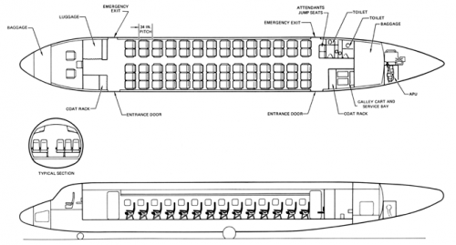

The definitive 70-passenger CL-246-1A13 model with a five abreast passenger-seating layout was to have a proposed gross weight of 24,086 kg (53,100 lb). Flying in the cruise condition at this weight, the aircraft would be capable of a trip from Washington to New York and return without having to refuel. This –1A13 model was to have an overall length of 27 m (89.0 ft), maximum height to the top of the central vertical fin of 7.2 m (23.5 ft) and it was to have a wingspan of 10.4 m (34.2 ft). The triple fin configuration was selected to ensure adequate vertical surface area was in the propeller slipstream for all yaw angles, however, only the central vertical fin had a full rudder. As with the CL-84 series, differential propeller pitch, rudder and aileron deflection was to be used to provide adequate control at slow flying speeds.

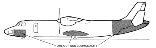

Potential military applications of the CL-246 aircraft for the CAF were studied in 1971 to replace or complement then current aircraft types in service. Some of the roles envisioned were for Sovereignty Surveillance, ASW, SAR, Air Transport, Training and VIP Flights. The CAF version would differ little from the civil STOL aircraft, with such additional features as a straight-in rear end loading capability using large clamshell type doors enclosing a drive-on ramp. This feature also aided in providing an airdrop capability.
In the cargo transport role, the basic CL-246 fuselage cross-section was compatible with the standard 463L-pallet system, and up to six pallets of this type was capable of being carried on a reconfigured floor. The interior layout of the aircraft could be readily modified to suit any envisioned intended military role. Soft-field, dual-wheeled landing gear would be utilized for access to unprepared or rough strips.
In the end, no prototype civil or military prototype model was ever built of the CL-246 STOL transport due to various factors at the time, among them higher than initially projected operating costs, environmental concerns, and lack of any military commitment. Concerns expressed often and publicly by the general populace and the misguided and uninformed about potential noise factors around the proposed STOLports in local communities were totally unfounded. American Airlines, having been an enthusiastic promoter of the idea, had dropped out of the project before the construction of any type of prototype could be started. With parent company, General Dynamics, showing little enthusiasm for this project, Canadair Limited, unable to finance the CL-246 on its own, eventually abandoned the project prior to 1972.

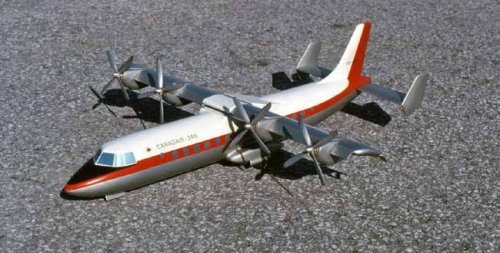

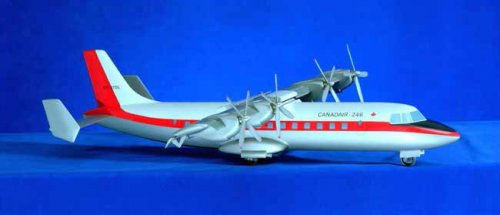

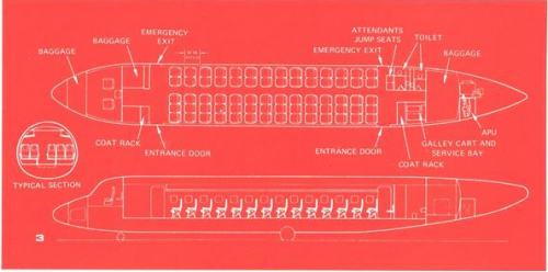

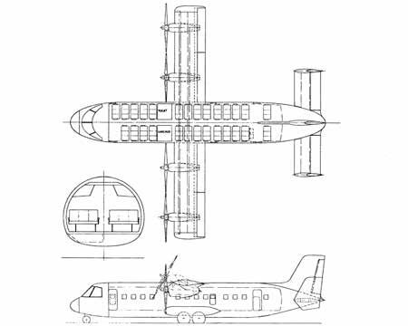

Apophenia said:
Hesham,
As promised long ago, here is the CL-286 cutaway from Air Enthusiast (Vol2 No 1, Jan 1972).
There never was a CL-286 VTOL project. This was the CL-246 (which the small resolution pic wasn't too clear about).
The CL-286 project was actually a 1981 primary trainer with a P&WC PT6A turbine engine.
