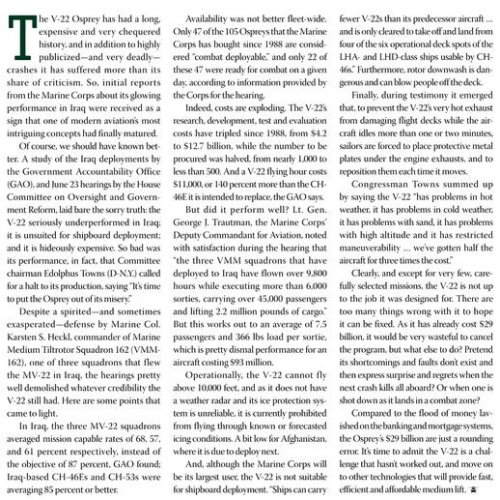

This month's issue of Rotor & Wing, quoting the GAO, seems to disagree. See the attached article (I apologize for the poor format; i wish I could have just copied and pasted text but it was a picture file).
The tilt-rotor technology does not seem to be the culprit in itself, but the operational history so far is underwhelming just the same. If this continues to be the case, I don't know how much longer the proponents of the V-22 will be able to keep it alive.

Well, the Marines themselves seem to be pretty content with the Osprey. Why should they defend the V-22 if they were not satisfied with its performance?
Are they afraid of being left with nothing if the V-22 gets axed?

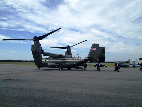

They are already in use, here's a shot of the arrival at Martha's Vineyard at the start of the latest vacation.
From a recent US press release, the V-22 will not carry the president, but only "support" staff and equipment. Like the beefy gentlemen in the cheap suits in the picture.

I posted the pic just to show that hte V-22s are now in use. Those beefy gentlemen are support staff and secret service. Oh, and Bo- the Presidential dog (not wearing a suit).

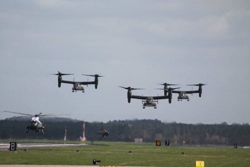

i saw HMX-1 MV-22B four years ago at RAF Mildenhall in the week of Obama arrivjg in U.K. April 2016. HMx-1 Marine One and Two Sikorsky VH-3D and trio of MV-22B did rehearsal flight from EGUN into London , escorted by National Police Air Support Airbus Helicopters H145.
The Mv-22B self deployed across the pond from MCAF Quantico stopped overnight at Lajes AFB then flew up to the. ‘hall.

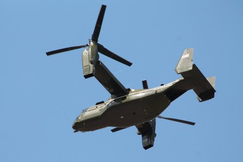

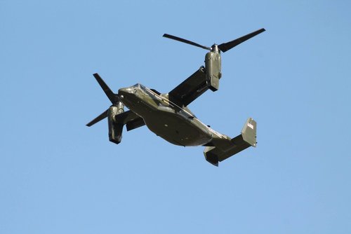

So here are my photos below.
cheers
77D8A98D-F0F1-4323-93E3-B1169FEE47AB.jpeg 387E0EDE-D680-4E9F-B0CD-DEB47F39044A.jpeg EDCF0074-11AB-464D-92CB-02143E641830.jpeg
