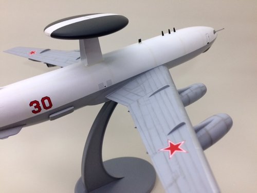

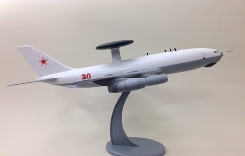

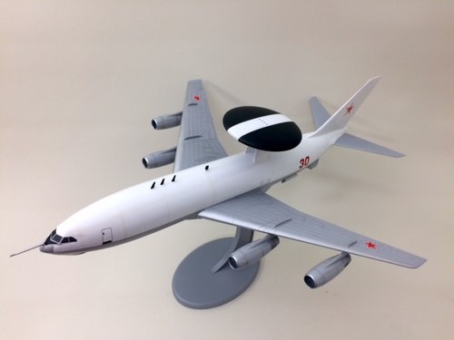

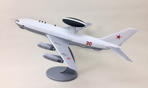

los rusos podrían haber utilizado il 86 como base para un awacs. Hice este en escala 1/144. Mis mejores deseos
(The Russians could have used the '86 as a base for an awacs. I made this one in 1/144 scale.)
What is the purpose of the chin mounted radome
