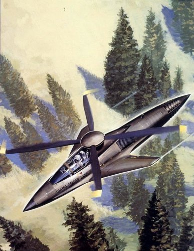

Hughes had a NOTAR system with a scimitar main rotar (Testor kits) and a convential rotar in early drawings.
Regarding the Hughes project/Testors kit, have you seen the American Aircraft Penetrator?
http://www.aviastar.org/helicopters_eng/bell_penetrator.php
Really just a fancy body based on a Bell UH-1 Huey. Apparently still in flying condition...
