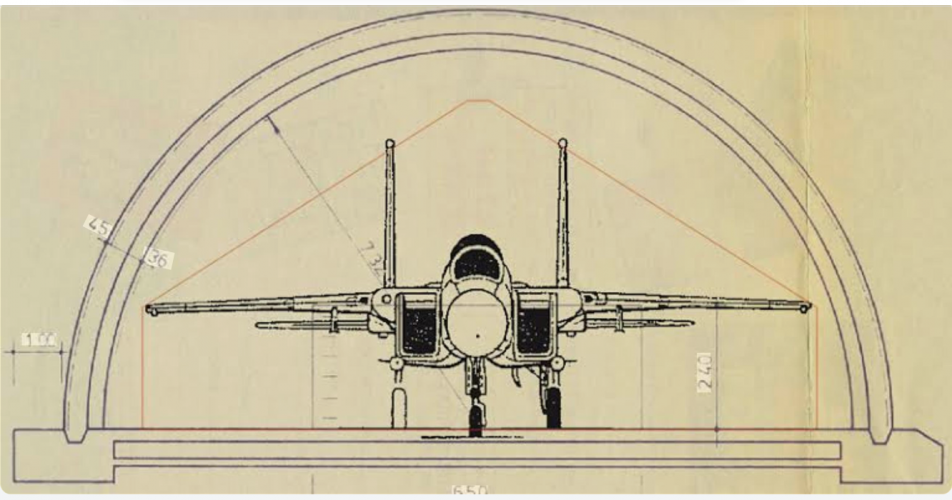

I realize what caused the F-35 length issue. But the HAS requirement caused the ATF restrictions. If you keep those restrictions but increase the weight another 10k. . . Fat Amy 2.0. If it's not a requirement then no problem, they can make it as long as they need to.
After reading what's in the public domain (wikipedia, reddit, etc.) I thought I'd clarify what determined the F-22A basic dimensions.
Wingspan: F-22A 44.5 ft, YF-22 43.0 ft, F-15A 42.83 ft.
The ATF requirement was the Gen 1 HAS, aka TABVEE, with its 24-ft inner radius (48-ft width at ground level). The F-22A proposal configuration increased the wingspan over the YF-22 and the F-15A via two unique features: 3.2-deg of wing anhedral, and a shorter landing gear. Internet buzz speculates that the anhedral was incorporated for reduced lateral-axis stability and hence snappier roll performance -- these kind of flying qualities improvements, if any, were a fallout. The combination of anhedral and a squat undercarriage enabled the 1.5-ft span increase, which provided improved aerodynamic efficiency in cruise and maneuver. The shorter landing gear also reduced weight-empty.
Length: F-22A 62.08 ft, YF-22 64.17 ft, F-15A 63.75 ft.
Due to its highly efficient caret inlet, relatively thin wing, and other design refinements, the F-22A proposal configuration was able to decrease the overall length by about 2 ft. As a general rule of thumb, fighter aircraft weight-empty grows by (length)^2.5. Even with a lower fineness ratio, the F-22A has superior supersonic performance.
So functionally the F-47 could have about the same wingspan as the F-15 or F-22, depends on how high the wingtip ends up. And the gull wing with a long inner dihedral with a short outer anhedral does NOT help us here. Assuming that the plane is designed around Gen 1 or Gen 1 Mod HAS.

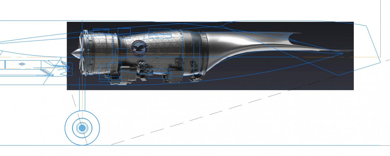

here i am, toiling away under the assumption that perhaps the sine qua non of an adaptive cycle three stream engine was the ability to functionally operate at a higher BPR than a fixed bypass engine like those mentioned in this thread.
As for the non engine bits and bobs - mass and drag reduction from deleting stabilizers, other aero improvements both from a planform and trim/control effector perspective, weight reductions from more modern materials and processes, moving away from legacy hydro based plumbing to more electric based, etc can be a self reinforcing spiral - powerful virtuous one if stakeholders keep laser focused and avoid performance creep. We remember the weight/death spiral that has hit many US a/c like the A-12 Avenger most famously, but forget an opposite or anti polar spiral is possible, however improbable.

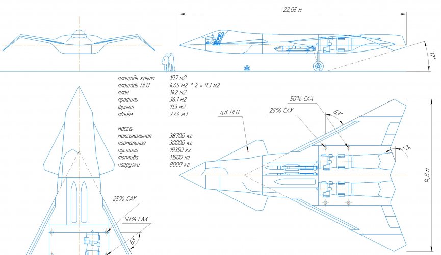

I'm sure most of you folks have seen the iceman fox1 page on YouTube, very good stuff.
Until we know the thrust in afterburner, the maximum takeoff weight is unknown. Until this is known, it is unclear what volume of weapon loads can be expected.
Currently, there are two options: the full‑fledged XA102/XA103 with afterburner thrust of 2 × 21,320 kgf and maximum thrust of 2 × 14,515 kgf; or a non‑afterburner engine variant with thrust of 2 × 14,515 kgf–15,810 kgf. In the first case, the maximum takeoff weight of the aircraft is 42,638 kg, and the weapon bay capacity is no more than 11.5 m³; in the second case, it is no more than 35,000 kg, and the weapon bay capacity is no more than 9.45 m³.
Wing area: 107 m²
forward horizontal tail area: 4.65 m² × 2 = 9.3 m²
plan area: 142 m²
profile area: 36.1 m²
front area: 11.3 m²
volume: 77.4 m³
mass:
maximum: 38,700 kg
normal: 30,000 kg
empty: 19,350 kg
fuel: 11,500 kg
payload: 8,000 kg
maximum and cruising speed: Mach 2.0 (2124 km/h)
Could you share the source of this image? Is this a bay designed for the AIM-174B? I think making it larger than the AIM120/260 form factor is a good idea, but making it too large, even for air-to-ground munitions, seems pointless to me on an air superiority fighter. If any extravagant munitions are needed, there is the B-21, the F-15 or CCA.
Paralay makes those images himself, usually based upon reasonable extrapolations of available evidence, or as a way of visualizing assumptions.
If we know the maximum takeoff weight, we will know the aircraft’s volume. Knowing the volume, we can estimate the dimensions of the weapon bays.
The relative volume of the weapon bays for the F‑22 is 10.3% / 6.73 m³, and for the F‑35A — 13.5% / 6.7 m³
I think 9.45 m³ is a realistically achievable volume for such an aircraft.

The calculated characteristics of the layout presented above, engines with an afterburner, column AH
English language in the column BA
eger-tab
Masses:
maximum: 40,700 kg
normal: 26,000 kg
empty: 20,500 kg
fuel: 12,000 kg
combat load: 8,000 kg
Maximum speed: 2,160 km/h
Cruising speed: 1,780 km/h
Supersonic flight range: 1940 km.
Flight range without an additional tank: 3105 km.
Flight range with an additional tank in the weapon bay: 4300 km.
Operating radius: 1100–1500 km (without external tanks).
Is such high thrust achievable today for engines the size of the F-110?
I also have a number of questions for experts in jet engines. What advantages can be gained by abandoning afterburning? How much weight can be saved without a afterburner, and is it possible to do without an adjustable nozzle?
I think if you can meet that thrust requirement without an afterburner then why not. But thus far Im not sure there is evidence that adaptive cycling engines can reach rhat thrust without afterburner. Was there some research done about it? Some expert opinion? I probably missed it if there really was.
The YF119 variant for the X-32 produced 34k dry but it was huge. Also, keep in mind exhaust velocity is going to limit your top speed and the higher your bypass ratio the lower your overall exhaust velocity is going to be.
  • Maybe the 2nd stream in a 3-stream engine can be diverted through the combustion chamber.
  • Maybe the 3rd (outer) stream is a duct-burner for extra oomph.
  • Maybe it has fluidic TVC.
That said, I'd be surprised if either the F-47 or F/A-XX didn't have afteburning engines. And I would think they would have TVC if only to aid in yaw control with no verticals.
