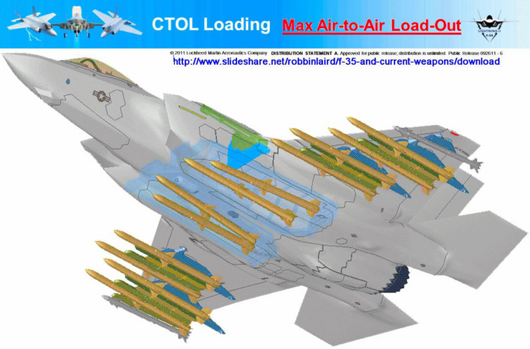

Since when can a F-35 carry 14 or 16 AAMs ? never thought one could hang so many missiles below a F-35... ?!
So, this 2011 slide from LM shows 12 AMRAAM -- eight external on four twin pylons plus 4 internal in the two bays. Upgrading the bays with the Sidekick triple rack makes for 14 AMRAAM. Plus a pair of AIM-9 or ASRAAM. And they've shown the same basic idea in 2017 as "Beast Mode."
Now, this is a hypothetical loadout -- it hasn't been cleared or tested and probably won't be. But mechanically, it's probably doable.
