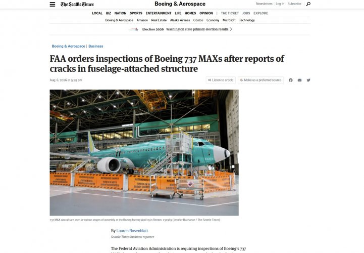

https://www.techtimes.com/articles/...d-every-jets-bear-strap-during-production.htm
TLDR: It's a high stress point, and 'hot bonding' the structure left minute scratches that have been shown to eventually develop into fatigue cracks on 737 NGs, and as the Maxes use the same parts and manufacturing processes, they're likely to be just as susceptible, they just haven't seen it happen yet.
I can't say I ever saw that on 727s, but the logic is sound. (I'm guessing that 727s used the same bear strap attachment method as 737s)
