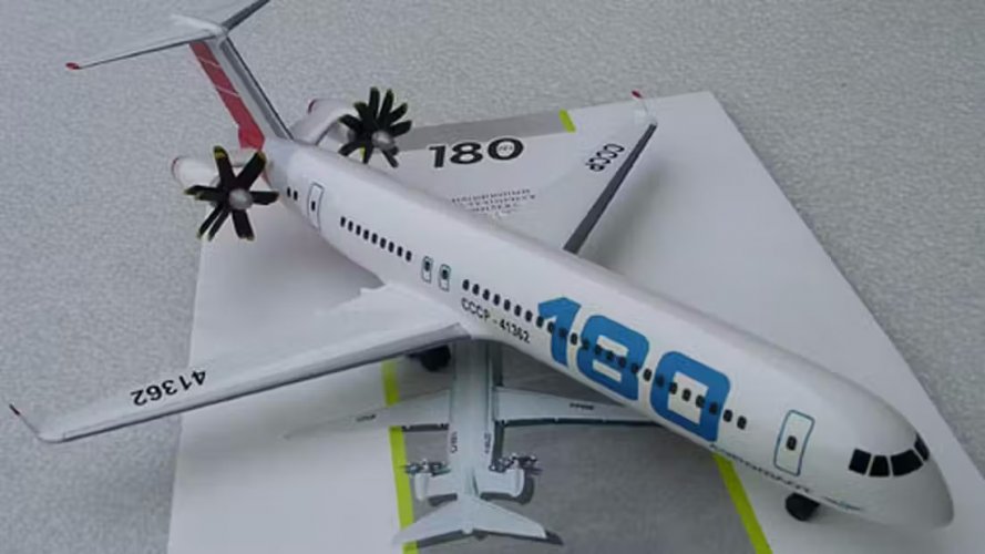

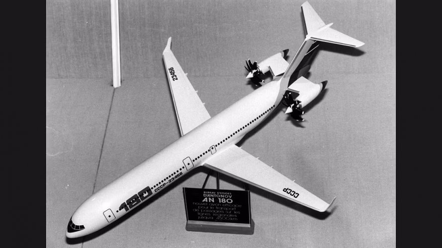

Antonov An-180

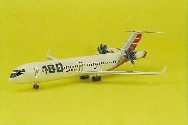

Type: Twin propfan medium-range passenger transport.
Program: Company funded program; first details, and model, at 1991 Paris Air Show; configuration changed, with engines on tailplane tips, 1992.

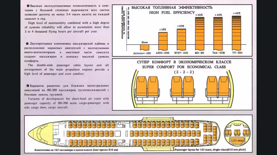

Design features: Unique configuration, with propfans at tips of dihedral tailplane; low-mounted sweptback wings, circular-section fuselage and all-sweptback tail surfaces. Designed to equal, or exceed, highest Western standards, burning less fuel per passenger-km per engine than equivalent Western aircraft; equiped for automated navigation at all flight stages, and for ICAO Cat. IIIa automatic landings. Airframe design life 60,000 flying hours.
Power plant: Two ZMKB Progress D-27 tractor propfans, each rated at 10,305 kW (13,830 shp), mounted on tips of tailplane.

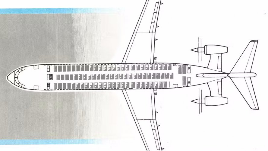

Accommodation: Two or three crew; single-class seating for 163 to 175 passengers or mixed class seating for 150 to 156, in pairs, six-abreast with two aisles; seven LD3 containers underfloor; four seats for cabin attendants by passenger doors (port side) and service doors (starboard); one toilet at front, two at rear. Available in 180/200-passenger, mixed passenger/freight, and all-freight versions with side-loading door. Emergency exit over each wing.

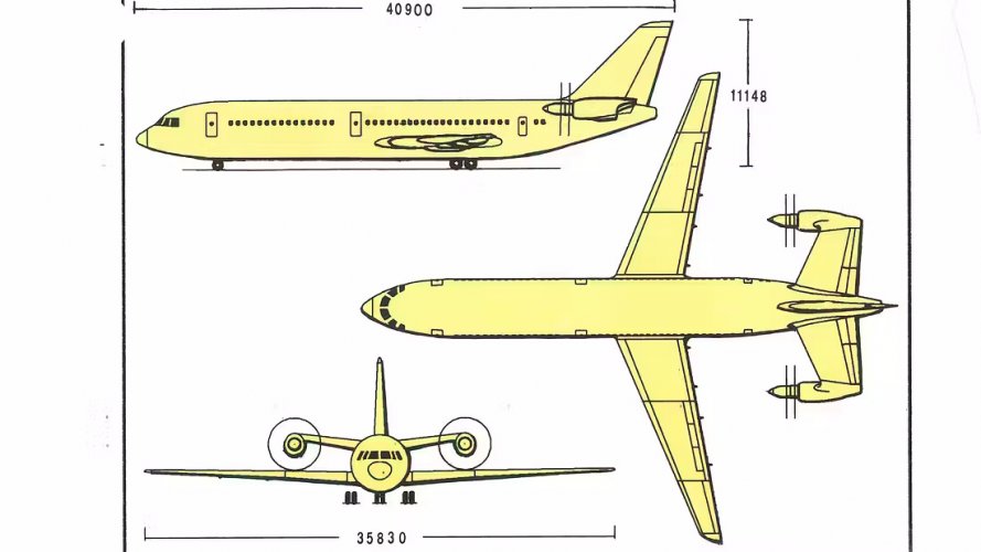

Dimensions external
Wing span: 35.83 m (117 ft 6.75 in)
Length overall: 40.90 m (134 ft 2.25 in)
Height overall: 11.15 m (36 ft 7 in)

Antonov An-180 (Pre-1992)

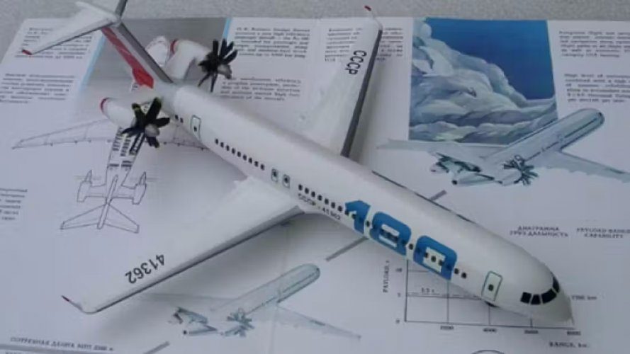

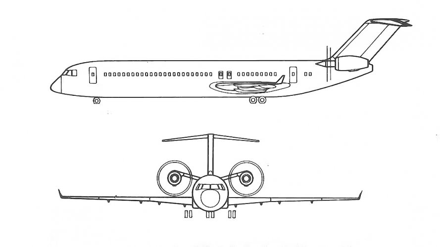

Program: First details, and model, at 1991 Paris Air Show; wholly internal program at that time; prototype intended for display at 1995 Paris Air Show.
Design features: Conventional configuration, with low-mounted sweptback wings, winglets, circular section fuselage and all-sweptback T tail. Designed to equal, or exceed, highest Western standards, burning approx 14.5 g of fuel per passenger km (0.05 lb/passenger mile) per engine.
Power plant: Two Progress/Lotarev D-27 tractor propfans, each rated at 10,350 kW (13,880 shp), pod mounted on sides of rear fuselage.
Accommodation: From 150 to 180 passengers.
