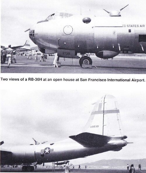

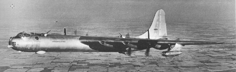

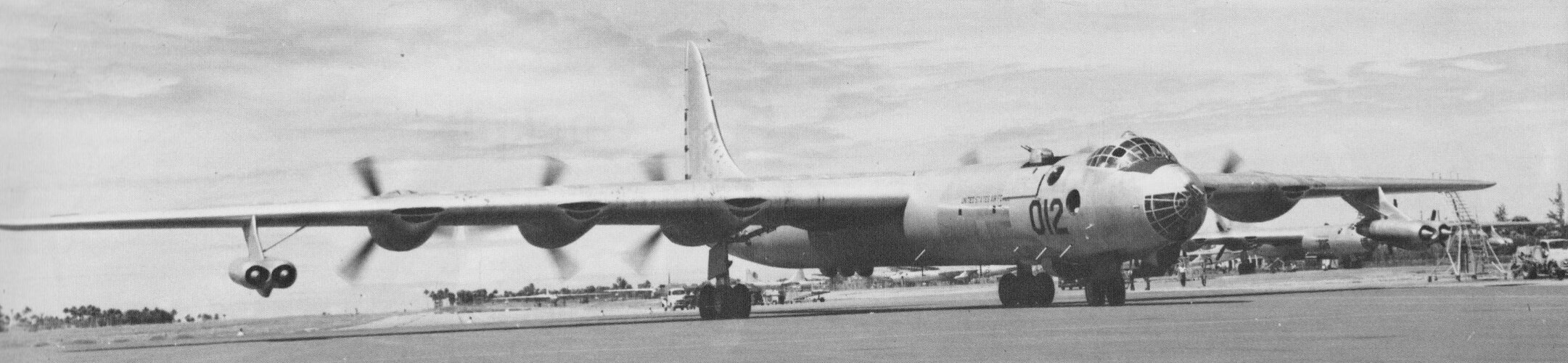

Does anyone have good pictures of what the B-36 looks like with the defensive armament deployed? It's supposed to have a metric F-ton of defensive guns, but I don't think I've ever seen them.
Not really "good" pictures, but a quick search makes me think, that the B-36 only rarely showed its full gun
armament.
Pictures from: B-36_01: Meyers K. Jacobsen "Convair B-36 Peacemaker"
B-36_02: squadron/signal N°42 "B-36 in action"
B-36_03 & 04: Meyers K. Jacobsen "Convair B-36 - A Comprehensive History of America's Big Stick"
Maybe interesting the caption of _02, saying, that the cover of the forward turrets was left open during take-off,
as an additional way out in the case of an emergency.
