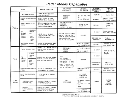

More usefully - here's the complete picture on ranges and modes, from James P. Stevenson's Aero Series Grumman F-14:

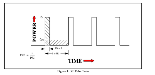

Many things included, but they mostly can be summed as better energy handling. Better antenna designs produce much narrower beams, thus needing less energy for same radiation density and return accumulation. Plus, as usual, measurement confusion: some state power as whole system consumption, some as specifically radiating element consumption, some as finalized power after all losses and so on.
Peak power is not important.
The most important is energy received from target and possibility to gather that energy (sum, integrate and so on)
Energy has to be higher than energy of background noise significantly enough.
And in older pulse radar power was high but radar emits short pulses with low pulse repetition frequency (RPM). So having radar 100kW, pulse width 1us and RPM 1kHz this gives mean power:
1us/(1/RPM)*100kW
10^(-6)/ 10^(-3) *10^5= 100W
On the other hand pulse doppler radar may emits pulses with RPM about 200kHz
and with peak power 5kW have mean power 1kW
And also important is how long your beam is over target (dwel time). This gives energy. Also radar have to integrate that energy.
If you scan fast this shorter time but you can faster refresh data or scan more in time.

So in radar we have 2 terms for power namely :
The Peak Power : This term is for the power of the emitted pulse, the maximum power of a pulse emitted by a radar.
Average Power : This term is a peak power but averaged in some point of "reference time". In pulse radar our transmitter does not continuously emitting in peak power, but there is a "dead time" in between pulses which referred as PRI Or "Pulse Repetition Interval". The average power is then calculated by dividing the time when the transmitter a single pulse which termed as "Pulsewidth" with the PRI. This yield the Duty Cycle.
This is how it's look like when depicted :
The early radar is characterized with very high peak power, very short pulse and rather long PRI. Thus relatively small average power.
Later in 1950-1960's People start to realize "Hey how about if we emit more pulses, we can get better average power and we can integrate the pulses for more range" And then a mode is born namely High PRF. This mode have high PRF, means they transmit more pulses compared to early radars, this in turn crank up the duty cycle.
Hopefully this make sense.
Anyway the image above is coming from this :
Yes, exactly this. It's not hard to generate a high power output for a short duration with long gaps between for traditional pulse radar. Its just not possible to generate very high power output for a 50% duty cycle High PRF radar - the electrical power needed would be unfeasible for the aircraft.
