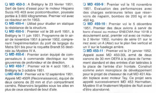

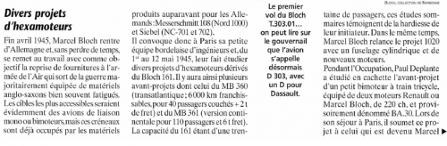

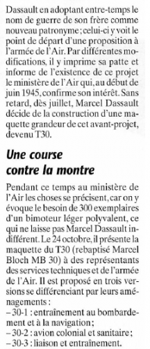

From Le Fana 447,
here is an Info about Dassault T30 Project and MD-301,MD-302 & MD-303.

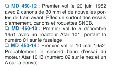

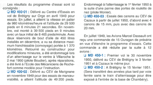

From Icare 188,
the Ouragan variants.

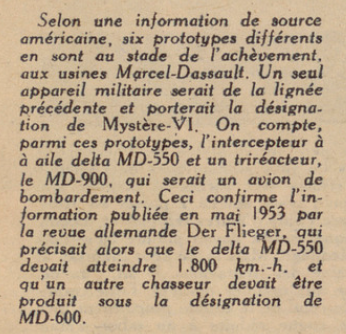

From Aviation Magazine 1953,
here is a strange Info about MD-600 fighter and MD-900 three jets bomber Projects;
According to source information American, six different prototypes are in the final stages,at the Marcel-Dassault factories. One military apparatus would be of the lineage previous and would carry the designation of Mystery-VI. We count, among these prototypes, the interceptor has Delta MD-550 wing and a three-engine, the MD-900, which would be an airplane of bombing raid. This confirms the information published in May 1953 by the German magazine Der Flieger, which specified that the delta MD-550 was to reach 1,800 km.-h. and that another fighter had to be produced under the designation of MD-600.
