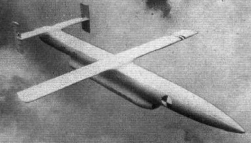

For those who want more detail on the Avioland AT-21 built between 1954 and 1958, Roskam's Airplane War Stories by Jan Roskam has lots of details about the AT-21 -- including a cutaway drawing (pg.73), photo of AT-21 on launcher (using the same RATO rockets as RNethN Sea Furies, pg.74), and 3-view sectional drawing (pg.76). Or see:
