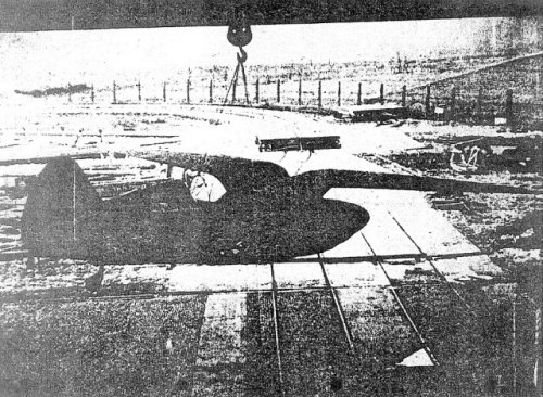

A picture for a mock-up from a friend;

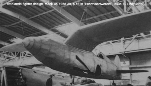

A little more on the Aviolanda fighter with another photo of the mockup:
http://www.studiegroepluchtoorlog.nl/bulletin-012-het-aviolanda-vliegtuig-dat-nooit-vloog/
Two bits on that Dutch webpage stood out for me were:
1 - "Motor: Rolls Royce 850pk (deze was al besteld)" The Dutch paardenkracht (equiv. to German PS) equates to 838 Imperial Horsepower. Too high for the Kestrel, rather low for the Peregrine. So what was the Rolls-Royce engine on order" for this Aviolanda fighter?
2 - "Ontwerper: Ir Rudnay"
That is a reference to Guido Rudnai, a Hungarian-born aeronautical engineer of Jewish extraction. Rudnai came to Aviolanda via Caspar Werken, Focke-Wulf Flugzeugbau, and Argo Flugzeugwerken. Although the Nazis prohibited Rudnai from leaving German (he had beens imprisoned briefly in 1933), he somehow managed to get to Budapest in 1937. From there he arranged a job with Fokker in Amsterdam. Ironically - in light of the fighter design in question here - the pacifist Rudnai left Fokker in 1938 because its focus on warplanes.
Amazing find my dear Apophenia.

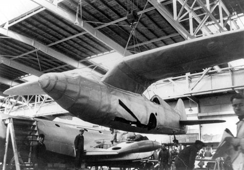

higher resolution image from; https://nimh-beeldbank.defensie.nl/memorix/59cf48e4-07aa-c7a6-07d7-8e1934a5611f

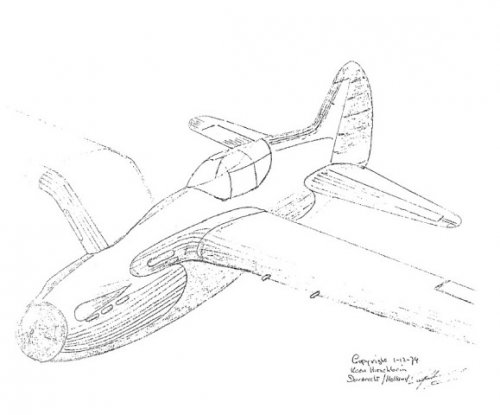

Please help,
in my files (old Info on the Net),there was a recce concept,designed by this company,any idea ?,or
it was developed from the Fighter Project ?,the source could be wrong,also I don't know if that
was pre or post WWII !.
Aviolanda hunter project 1939
Just before the war, this project was in the mock-up stage but was still abandoned. It was a design by Mr. Routnay, a Hungarian who had studied in Austria.
The project was terminated when Aviolanda became too busy with the license construction of the Do 24 flying boats for the Naval Aviation Service.
You don't need to translate every word ... in fact, it is better if you don't. How about:
* Aviolanda fighter project - 1939
Just before the war, this project was at the mockup stage but was then abandoned. The design was by dhr. Routnay [sic, Guido Rudnai], a Hungarian who had studied in Austria.
The project was terminated because Aviolanda was busy with the license-building of Do 24 flying boats for the Marine Luchtvaart Dienst.
