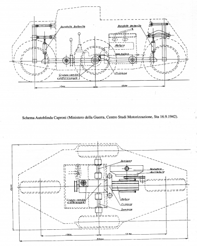

Yes Alcides,
I can add something:
this small scout car was designed by Eng. Ottavio Fuscaldo (Not to be confused with that Fuscaldi that designed the well-known postwar Italian 105-mm field howitzer). The Vespa (wasp) was one of the last projects by Fuscaldo with diamond wheels. A prototype, perhaps the second one, was shown to the Italian Army in September 1941, competing with the Lancia Lince (itself a bare copy of the British Daimler Scout Car Mk.I Dingo). The Wasp was the loser and its development was discontinued.
Nothwistanding, the prototype was taken in charge by the the 6th Motorized Regiment in Bologna and probably was still there at the date of the armistice. There are unsustantiated rumours of its service with Esercito Repubblicano (the Italian pro-German army after September 8, 1943).
I personally hoped to find a prototype of the Vespa in an old Caproni factory at Vizzola Ticino (Varese) where I found another interesting prototype: the CEMSA saloon car designed for Caproni by Eng. Antonio Fessia and some splendid and intriguing aircraft, but no trace of the armoured car!
From the technical point of view, the Caproni Taliedo (Fuscaldo) Vespa has a two-man crew. Its engine was a Lancia Tipo 91 Astura III Serie (2,9 liters, 8V, liquid-cooled, rated at 82 Cv at 4,000 rpm); the gas tank contained 62 litres. Dimensions are: lenght 3.90 m, width 2.00 m, height 1.85 m, ground clearance 0.28 m, wheel track 1.65 m, wheelbase 2.90 m.
Weight and protection are: loaded weight 3,410 kg, armour from 8 to 26 mm.
Performance are: max speed 80 kmh, range 200 km, fuel consumòption 31 lt/100 km (3.2 km/lt), gradient 35%.
Armament was a 8-mm Breda Mod.38 machine-gun.
Nico
Nico thanks a lot for the data. The Vesca scout car looks more, and more interesting to model ... I just need a 3d view .. snifff ... :-[

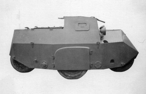

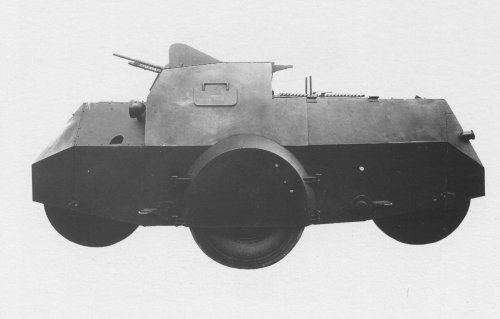

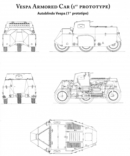

Ok, i scan some pics ;D
First prototype, post 1

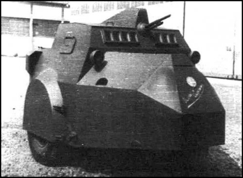

Post 2

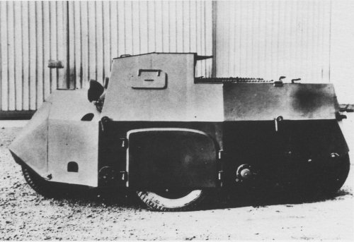

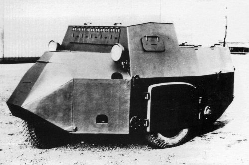

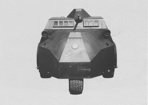

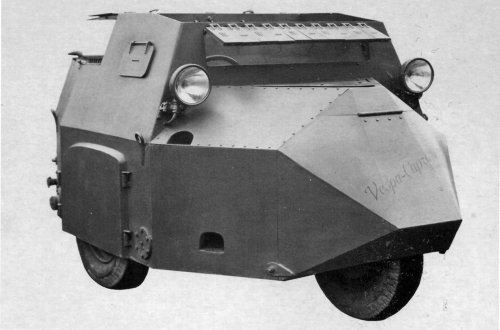

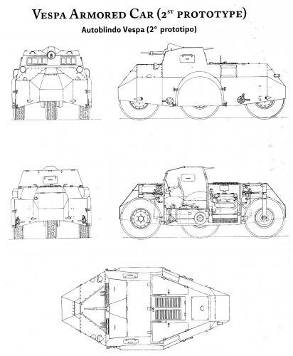

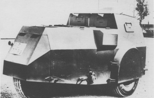

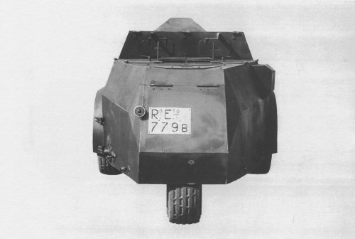

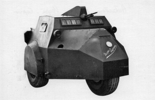

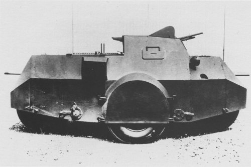

Second prototype
Post 1
Also - http://www.amazon.com/Century-Italian-Armored-Cars/dp/B0057SJAB0
Must have book about italian armored wheeled vehicles.

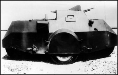

Post 2
