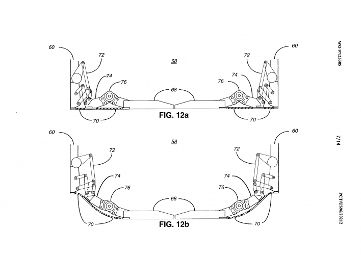

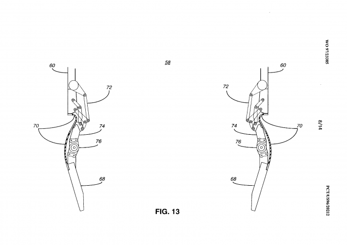

I was looking for the F35's bay patent drawing (couldn't find it) and found this abandoned MDD one. Based on the date it was probably for ATF but for some reason abandoned. Perhaps the flexible material wasn't as good as hoped.
As you can see it has very intricate, yet, neat mechanics. All the links even as simple as a bicycle chain might be troublesome to maintain and prone to bending.
Can't beat rotary, planetary actuators and connecting rods interfaced to the doors. Can have a direct rotary actuator interface with no connecting rods providing the actuators and drive units have enough oomph. Can't use linear cylinders in small bays, eats up up crucial bay volume for weapons. B-2 (and I assume B-21 as well) has rotary units with push rods and F-117, linear hydraulic cylinders (inboard, fore and aft), 117's only carried a single weapon so you could live with the cylinders taking up some volume with the doors closed.

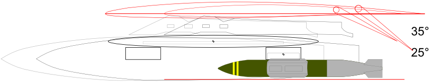

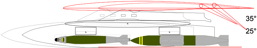

I will note that this does make for 2-4 "main bays" that make it impossible to load weapons on the centerline.
For example, the A-12 ATA has one bay option for 5x 1000lb weapons, and my early concepts for an FAXX design could have allowed 3x 2000lb weapons in a bay wide enough for 2x AGM-158s. That would not be an option for a setup like NATF23's bays.
Admittedly, I'm not sure what kind of mission would require 2x SiAW and 3x 2000lb or what mission might require a full up 6x 2000lb, but with the AGM-158s weighing nearly 3000lbs each and the ~65" width being plenty wide enough for 3x 2000lb, I was wanting to make it an option.
I think it's okay, but I was preferring the heavier load being an option.
The bays will need to have some custom racks made for the alternate weapons loads. Annoyingly, likely custom racks for each weapon type: SDBs, 500lb, and maybe 1000lb.

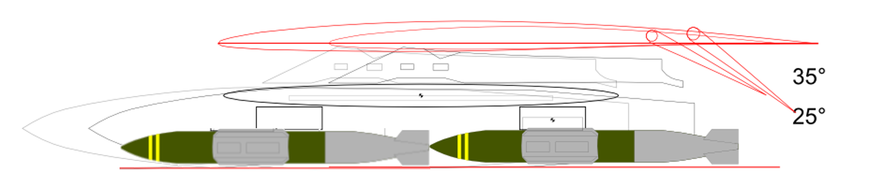

How deep would a bay need to be in order to hold a pair of 1000lb weapons within the same width as an AGM-158?
About 32.15" but must be staggered due to the tail wings.

Increasing the load to 4x 2000 lb internally is the logical next step for improving on the F35. I don't think more is needed if we want it to also serve as air superiority. As is it's a great multirole.
Agreed that you need at least 4x2000lbs for FAXX.
My thinking about 6x2000 was because a bay wide enough for 2x AGM-158 is also wide enough to hold 3x2000, plus 4x AGM-158 is very close to 12klbs.
Grr. Deeper than I wanted.

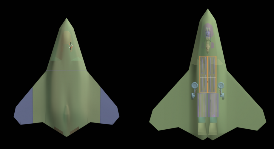

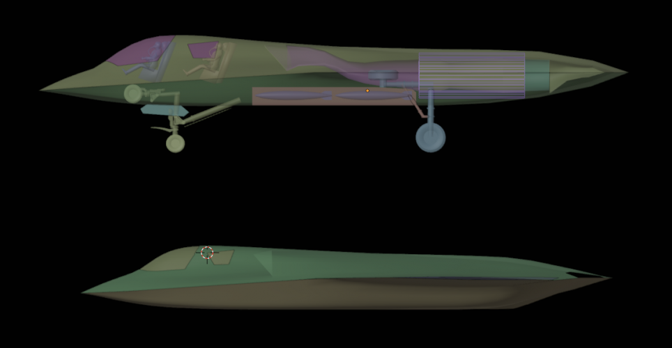

My doors are anywhere between 23.6-22.44/570-600 mm depending on the opening mechanism. This requires F22 ground clearance.
My biggest fitting issue is match fitting the main landing gear, wing & actuator space and side bays. I might have to lenghten the air frame just because of this rather than the IWB length.
i think FAXX is going to be F18E sized. it will use large but fairly swept back wings 42 degrees or more. may have some sort of vertical/canted stabilizer not so much for stability but for better low speed approach control or just none at all. big enough weapon bays for multiple (2 or more) anti ship missiles and then rely mostly on drones for air to air combat loads
That's my goal but it's not that simple. The USN puts more constraints than the USAF on size...
My thoughts on the wings was the F/A-XX doesn't need to be as fast as the F22 but the USN probably wants to claim / to have a Mach 2 fighter.
Design wise I've set the max limit at M2.2. Most of the time it won't go that fast. Intercept or tactical surprise are the only cases where such speed would be needed.
I figure it doesn't need to fly as high nor as maneuverable at those altitude as the F-47. The USN demands range and "longer" loiter time.
This requires L/D efficient (good aspect ratio, too) and sizeable wing area.
My design needs is a long wing root to cover the main landing gear, flap+actuators, side bay length.
That's why I'm currently set on a wing area of 1100 sq ft.
However, this reduces wingspan and leaves very little chord length space for the 3rd wing station. My 2nd planform choice (spiky diamond) fits but is too compact.
I went with the spiky end due to stealth angle reason and drag reduction of the wingtip vortex.
If the wing root is too short the wing span increases (for same area) and I can't fit everything.

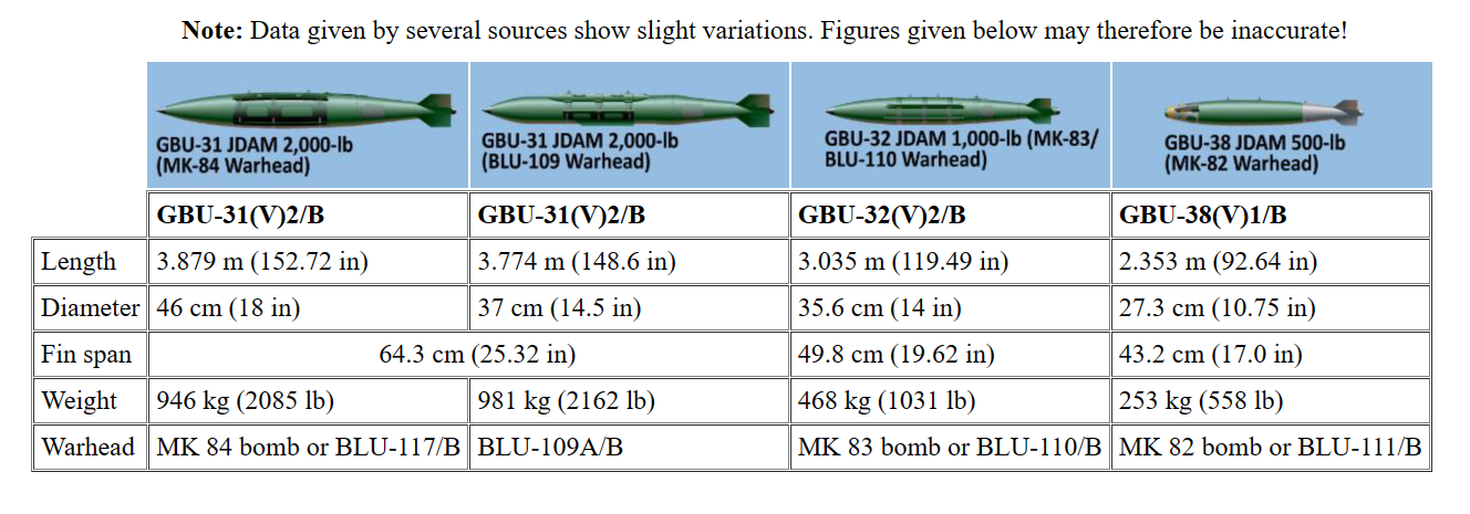

I'm missing something(?) if the Mk83 is nose to tail they don't seem to fit in tandem.
Sorry, I somehow was fixated on the wing's spacing and forgot the rest.
@Scott Kenny is right the Mk83 won't fit in the same row.
But for a 5000 lb rated station (presumely at 5.5g) we can't mount 6x 1000 lb without having to accept a lower gee force limit anyway.
The best use is a mix of 3x 500 lb and 3xx 1000 lb ~4600 lb of stores + BRU-41/A lb rack + SAUU pylon for a total of ~5300 lb.

Btw. I haven’t read through all the forum history, but what is your process for modeling? Is it CAD (surface/solid) or point cloud modeling?
It's a solid model created in Solidworks.
When I start I have a general idea of the external layout in my mind, but I always design the internal layout first (weapons bay, engines, intake ducts etc.) and then design the airframe around it... If I'm happy with the initial result I proceed, refine the model and add additional details, e.g. landing gears, doors, etc.

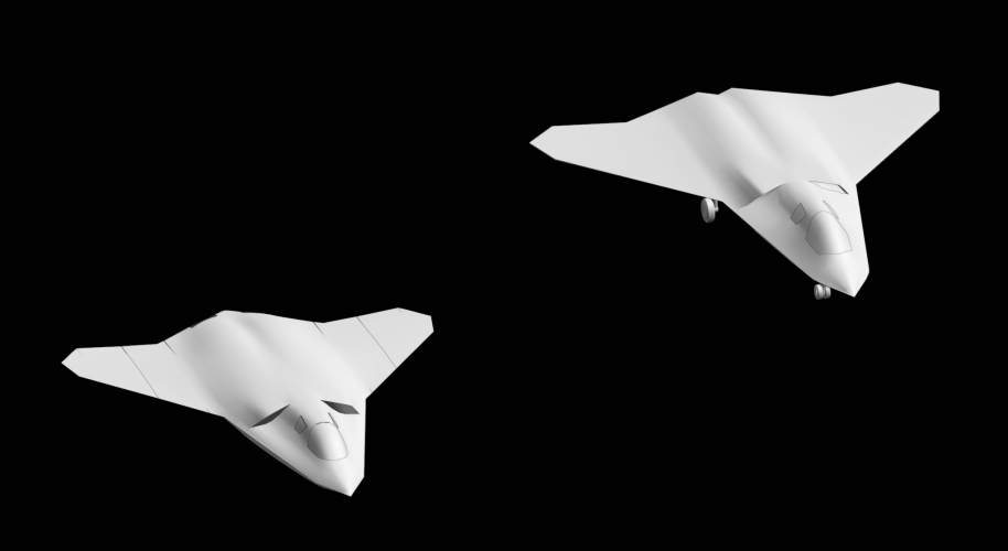

1772833732861.png Took a break from modeling, but came back and started over again.
The old version is on the left and the new one on the right. The new version can accommodate two of the weapon bays that @VTOLicious came up with without any compromise while still having enough room to stow the front gear assembly and the tailhook. I might be able to fit a single AAM per side bay too. Volume wise, we are looking at 88m3.
Should have better aerodynamics now with a sleeker fuselage.
This spec? 2x 500lb in tandem?
I agree, 4x 2000 lb seems to be a reasonable internal loadout, given the F-35C can carry only two.
However, I also think it's necessary to accommodate as many 500 lb JDAMs as possible. This led me to believe the bay length should be based on two 500 lb JDAMs end-to-end (5m / 197 in).
I agree with the thinking, but we may want to lengthen that to 3xSDB in tandem, 5.7m or thereabouts.
That also means a bay long enough to carry an AGM-158B/C with room to spare, but only wide enough to carry one.
My thinking is a bay wide enough for 2x2000lb as a minimum and 2xAGM158 as optimum, and long enough to have 3x SDB in tandem. 12x SDB per bay if the bay is only wide enough for 2x2000lb. This would require a rack that is half a BRU-61/A, carrying 2x SDB in parallel.
A bay wide enough for 2x AGM-158 is also wide enough for 3x 2000lb! So now we're talking 18x SDBs per bay, or the ability to pack 3x 2000lb and 6x SDB per bay. For the 500lb JDAM, you'd be talking 6x 500lb per bay.
Yeah. 2x 500lb tandem. It could maybe add a third one if we sacrifice some exhaust length.
After working through two of these, I really begin to appreciate the F-22 J-XDS kind of exhaust. It doesnt add extra length with a long exhaust, it can free up room for larger bays and it offers easy access to engine maintenance.
