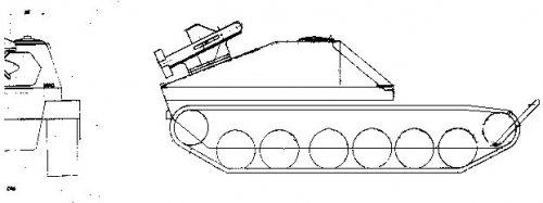

Development of the FV4010 Heavy Tank Destroyer started in mid 1953 and by June 56 had been designed to carry 20 guided missiles based on the Centurion tank. Apparently the system was tested in late 1958 at Woomera. But was cancelled because of the advent of the Chieftain and new ATGW programs promised in the 57 White Paper.

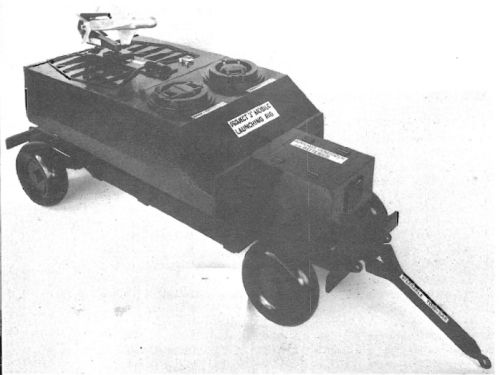

Here is a picture of the armoured Malkara launching rig. The key thing this rig explored was under armour loading and storage of guided missiles. Which at the time before containerised ATGW were developed was quite complex and difficult to achieve.

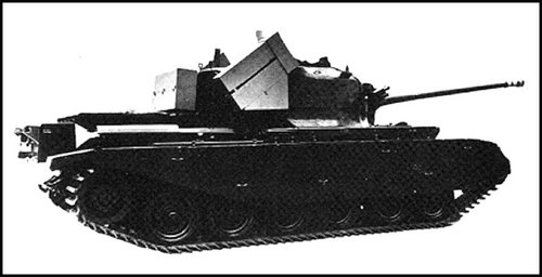

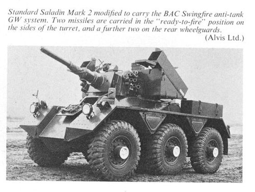

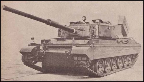

A bit of googling turned up the attached images showing Swingfire configurations for Centurion, Saladin and Vickers MBT Mk.2. The Centurion appears to have four ready fire missiles and two stored on the back of the turret, it looks like a mock-up configuration to me, I suspect any Chieftain configuration would have been similar. The Vickers MBT Mk.2 configuration appears to mount the missiles behind the turret on the engine decking.
That Centurion mount appears to be the rear of the turret rather than the engine decks, that would reduce the ability of the turret to be rotated.
Actually, they are mounted either side of the turret bustle.
