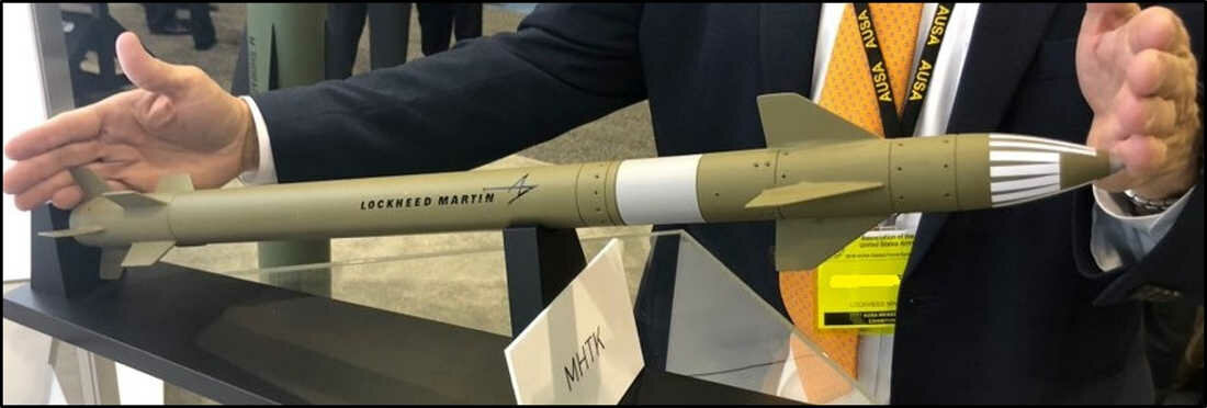

They need a dirt-cheap version of this:
Like a mini Iron Dome maybe. Lose the active seeker. Maybe AESA-controlled semi-active radar with a cheap IR sensor?
The USN experimented with laser guided FFRs launched from F-18s and guided by sniper pods. The U.S. Army has a ground launched version it is experimenting with; I believe there are some donated to Ukraine as a kit that can be installed on vehicles as small as civilian 4x4s. There are also warhead equipped Altius 600s the army has used for C-UAV. Roadrunner seems to fall into a much higher performance region then things like Altius though; it seems perfectly capable of engaging class 3 / MALE UAVs. At that price point, it is far more cost effective. Also it seems clear direct engagement of UAVs with a warhead is just an initial use case; the design has a lot of utility for other payloads. Shahed interception probably has nothing to do with its design goals, although it would still be a cheaper weapon for that then most any SAM.
Let's see them beat the per unit cost of the Tamir the USMC is acquiring in the thousands.
I suspect that purchase will be put on hold given current events. But I do marvel at how inexpensive that weapon is claimed to be. I don’t see how they can make that price point with a medium range solid rocket and active radar seeker.
