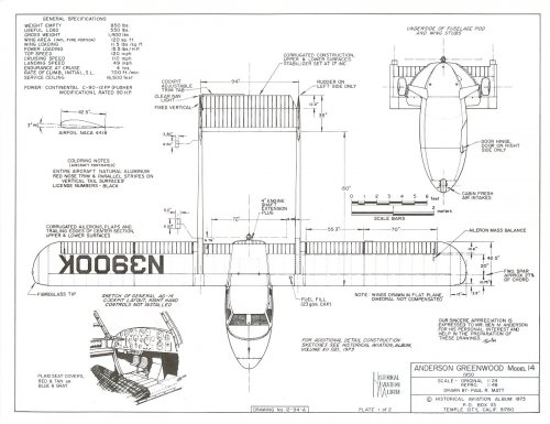

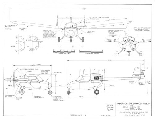

Here is a wonderful plan of the AG-14 by the great Paul Matt:

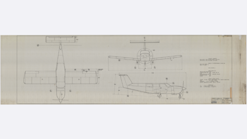

And the second plate:

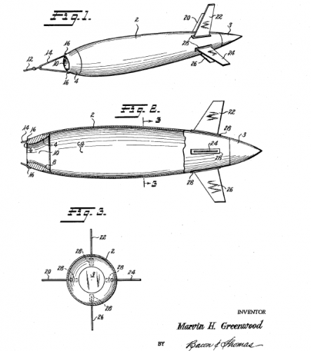

here is the Anderson-Greenwood developed a lightweight aerial target intended to use for
anti-aircraft practice.
Air Pictorial 8/1958
http://www.freepatentsonline.com/2930619.pdf

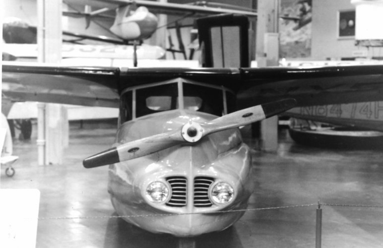

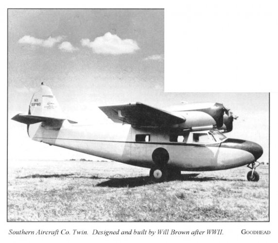

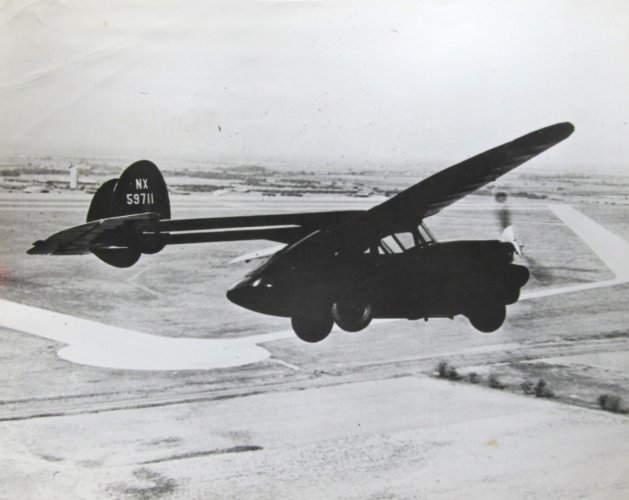

Also, Southern had two more products in 1946 and 1947: the Southernaire Roadable (NX59711, c/n unknown), a roadable aircraft with twin-boom tail, designed by Ted Hall and considered for possible production; and the XC-1, a two-seat high-wing cabin monoplane with a 130hp Franklin engine (not found in registers, so it could be the same aircraft modified). If the AG- list took over from Southern's own, where would these two fit in your list??
