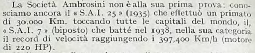

here is again Info about SAI-25,Page 39.
http://www.avia-it.com/act/biblioteca/periodici/PDF%20Riviste/Ala/L'Ala%201947%2008.pdf
No OCR issues with that L'Ala pdf but article author, RA Arnhem, does mentions this 'SAI.25' in the context of Stefanutti's S.1001 Grifo. That being the case, I still suspect a typo for the Grifo's predecessor, the SAI S.2S. (The 1935-1936 dates associated with the 'SAI.25' also correspond roughly with the SAI.2S.)
