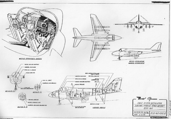

So - why not stick the APQ-81 in a big nose, and a few Bendix Eagles in the bomb bay ? (yes, I do know a few A-3s were "hired" as testbeds to do exactly that: flight testing of AMQ-81 & Eagle, early 1961).

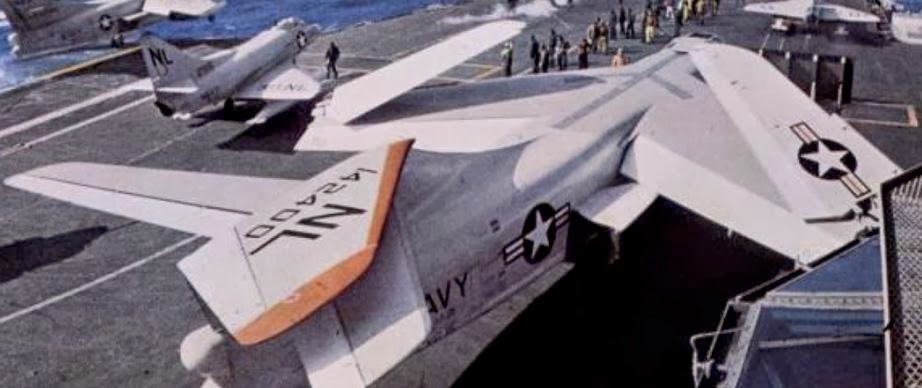

Probably the biggest problem is that the Skywarrior is huge. This is a problem on two levels: first, it can't fit at all into the hangers of the Essex and Midway classes. Second, it takes up a ton of parking space. As in, almost twice that of the F-111B, let alone the smaller Missileer.
I have been told that the A-3 also could not be recovered aboard safely if there were a problem with the tailhook--too heavy for the barriers. It is an old design that lacks ejection seats as well, so ditching or bailout at low altitude were not survivable.
Skywarriors were assigned to Essex and Midway class. That's why their tails folded down:
Fully agree on the deck-spot factor. They weren't nicknamed 'Whales' for nothing!

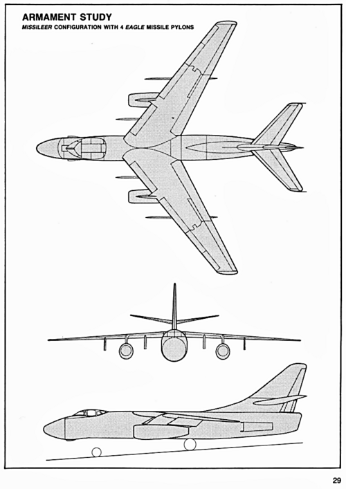

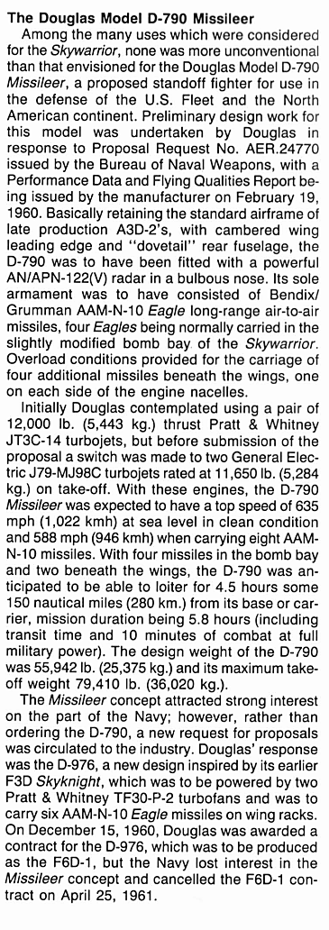

Thought I'd already posted this here . . .
Douglas D-790 Skywarrior missileer concept, up to 8 Bendix 'Eagles' . . .
Source Aerofax Aerograph 5, 'Douglas A-3 Skywarrior', pp. 29-30
