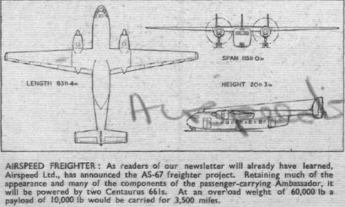

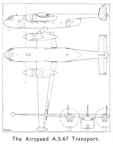

3-view from Putnams "Airspeed Aircraft Since 1931":

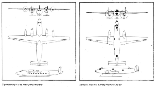

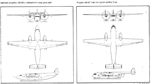

From L+K 20/1991.

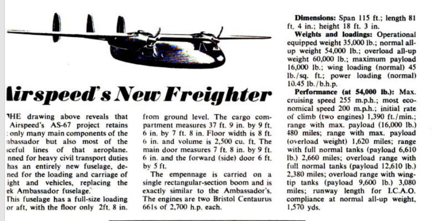

From Air Pictorial 1951.
