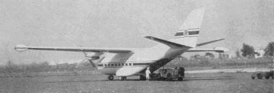

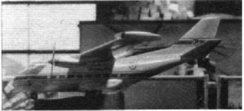

In JAWA 1960-1961 an Aerfer STOL transport with two turboprop engines is mentioned. A display model was supposed to be exhibited at Le Bourget air show in 1959, but that's all I know. Please help to find more information (picture of the model, general arrangement, type designation, specification, etc).
Maybe it's the Aerfer 150? The German magazine aero from July 1959 mentioned such an aircraft on page 156, but I have no access to this issue. Richard, do you have the magazine (or Xerox copies resp. scans) in your collection?
Hi boxkite!

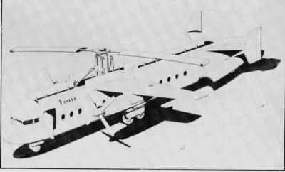

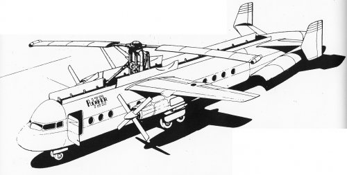

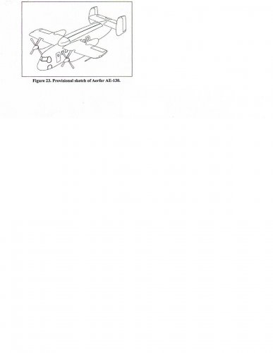

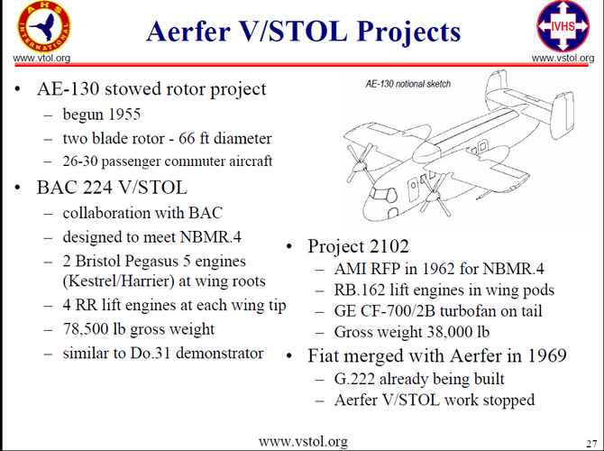

I found this illustration of the Aerfer 130. (Maybe we're heading in the right direction ar least!)
Chuck
Actually, that picture is an illustration out of the vstol.org pdf file on Italiant vstol efforts,; so it may be considered a provisionally accurate representation of this stowed-rotor aircraft.

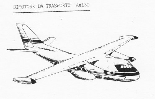

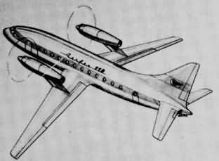

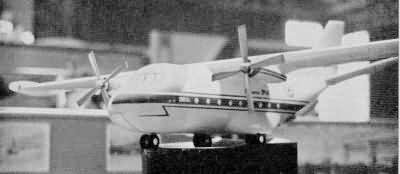

The Aerfer AE.150.
Swept wings and turboprops, that a bit different. Any idea of overall size and/or engines?
Sorry elmayerle,
I have no data about it.

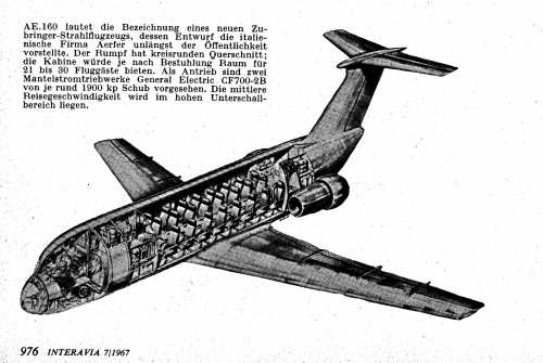

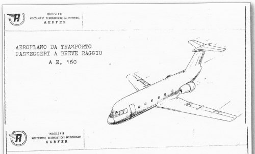

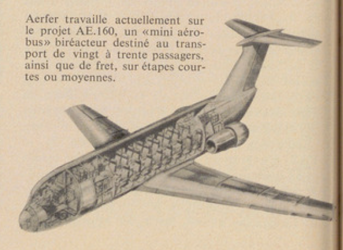

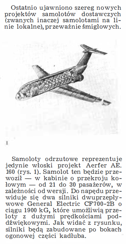

Aerfer AE.160 Commuter Aircraft project
Source: Interavia Germany. July 1967, page976
More Info at these Italian sites:
http://xoomer.virgilio.it/aviostoria/A/AERFER/AE-160.htm
http://xoomer.virgilio.it/aviostoria/A/AERFER/AERFER.htm :) B)

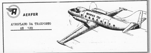

Aerfer AE.120 was a twin engined civil transport aircraft project of 1956,powered
by Mamba MK.504 turboprops.

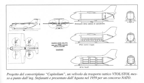

here is a drawing to Aerfer Capitolium VTOL tilt-rotor Project of 1959,designed by
Sergio Stefanutti as I think.
http://www.portaledifesa.it/forum/showthread.php?tid=1227
Aerfer AE.130 W.01 of better quality.
Source: Gente dell'aria volume 7 (p196)

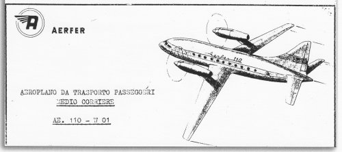

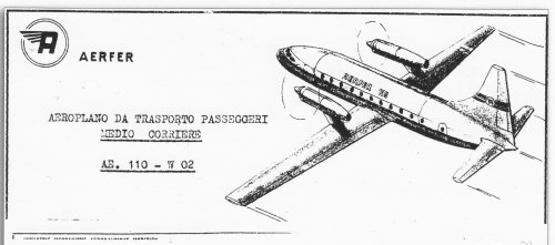

The next pile of Aerfer projects.
- AE.110 W 01
- AE.110 W 02
- AE.120
- AE.150
- AE.160
Again from Gente dell'aria vol. 7 (p199 nd 201)
