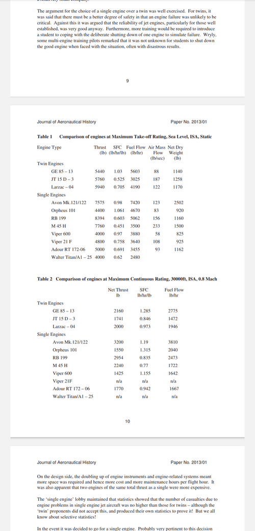

If it is, then it's likely because it's a scaled down version of the original RB.172 which was closer to RB.153 or RB.199 or M.45 in size.
Two J85s were lighter than one Adour (both reheated versions) by 200 kg/450 lbs; single non-reheated Adour weighted almost as much as two reheated J85s. One old-tech Avon weighted 300 kg less than the two Adours, while making same thrust as these two combined.
Yes, I'm comparing turbofans vs. turbojets, here, but anyway the weight/thrust discrepancy is amazing.
We can take a look at the RB.199, too. Weighted 20% more than the reheated Adour (976 vs. 810 kg) while making 80-100% more on reheat and 35-50 % 'dry'.
The old Bristol Orpheus also had an amazing thrust to weight ratio, perhaps it is too bad it wasn't developed into at a 'leaky turbojet' version? Development of the Pegasus shows the untapped potential of the Orpheus IMO.
Turbofans are always going to be heavier than turbojets. The benefit is increased fuel efficiency.
J85 was designed for light weight and initially short duration disposable use. It had high thrust to weight but also high specific fuel consumption. Orpheus was somewhat similar.
Adour was designed to be low risk, rugged, reliable, and reasonably efficient on fuel. T/W ratio was about 4.75 which isn't far off the Spey (5:1). Some versions had limited reheat only.
J85 reached 8:1 T/W ratio with later versions but was a very different engine.
The Adour was initially designed well within the limits of technology available when its specification was formulated. The aim was to produce a relatively simple and rugged design, with modest operating temperatures, capable of performing reliably under the demanding conditions required for training and for the low level strike role.
The Adour engine cycle was chosen to meet the demanding requirements of ground attack and advanced training. A low bypass ratio of 0.75 to 1 was chosen to combine a small frontal area with the good fuel economy of the turbofan, and to provide the capability for substantial thrust increases through afterburning. Also, the traditional turbofan thrust lapse rate with altitude is minimized at this bypass ratio, providing good climb performance. Moderate operating temperatures and pressures were specified and combined with rugged construction to provide good reliability, high resistance to FOD, and considerable potential for thrust growth. Substantial improvements in maintainability were provided by grouping all major accessories on the underside to provide easy access, and by adopting modular construction.
Source: The Rolls-Royce/Turbomeca Adour The Optimum Trainer Engine

2 x J85-13 weighed 1,195lb and produced 8,160lb thrust in afterburning, which is 6.8 thrust/weight ratio, with SFC 1.26 in dry thrust
1 x Adour Mk 102 weighed 1,552lb and produced 7305lb thrust in afterburning, which is 4.7 t/w ratio, with SFC 0.75 in dry thrust
1 x Adour Mk 104 weighed 1572lb and produced 8040lb thrust in afterburning, which is 5.1 t/w ratio, with SFC 0.75 in dry thrust
So for 377 extra pounds, you get similar maximum thrust, but your dry SFC is so much lower that it will make a big difference for range in a strike aircraft mission. You'll actually save weight on the fuel needed for the mission.
For a short range lightweight air-air fighter, the J85 is a better option.
For Jaguar, the Adour is a better option.

Also "A Shuttle chronology" a damn fine NASA history series from 1987. Volume 3, page 210 of the pdf.
  • A_Shuttle_Chronology_1964_1973_Vol.3.pdf
